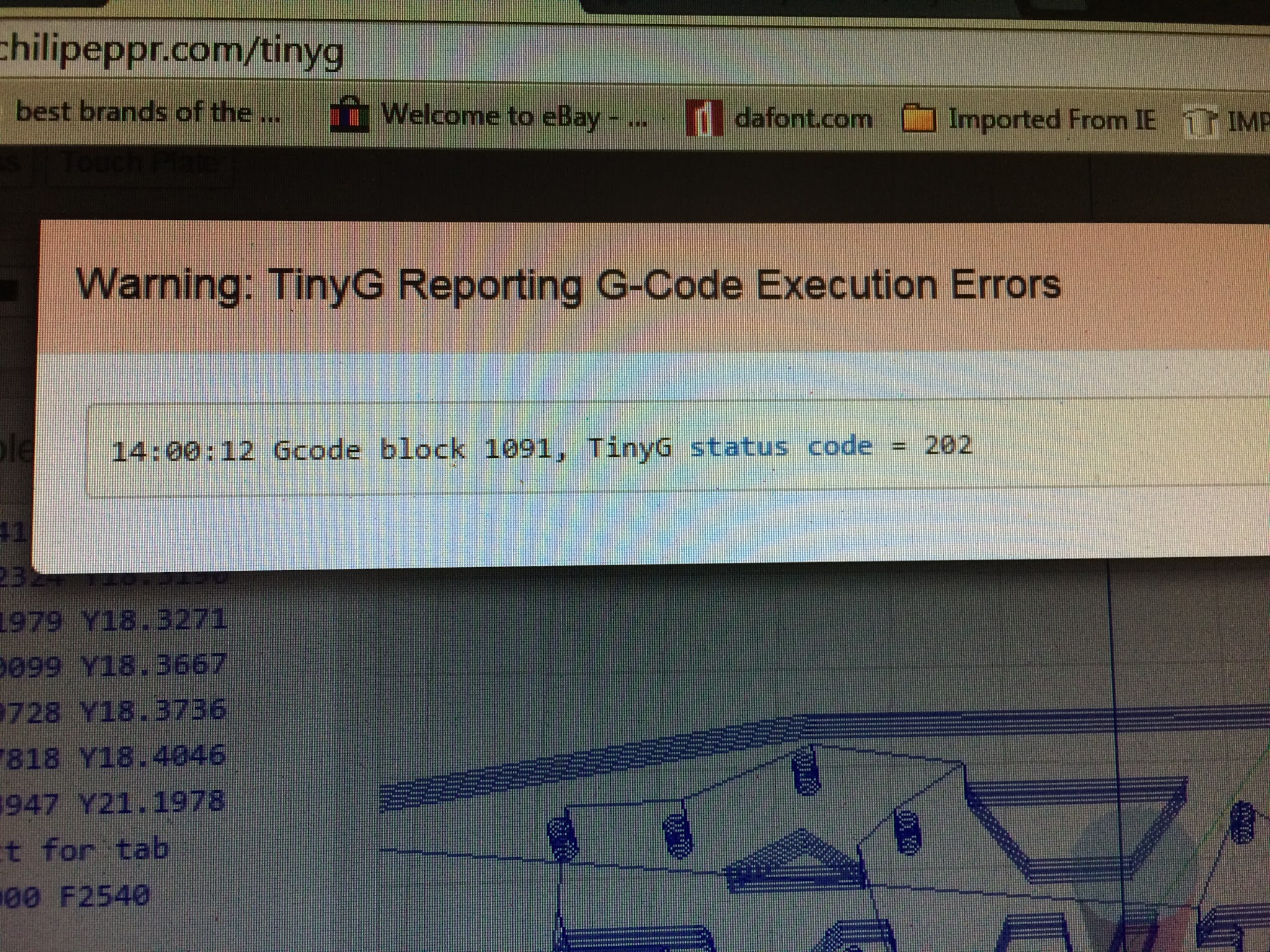

My OX stops cutting and this comes up?
Hit refresh. We just turned the error checking back off. It was too aggressive.
ok thx
Working again!! aggressive errors = bad!
