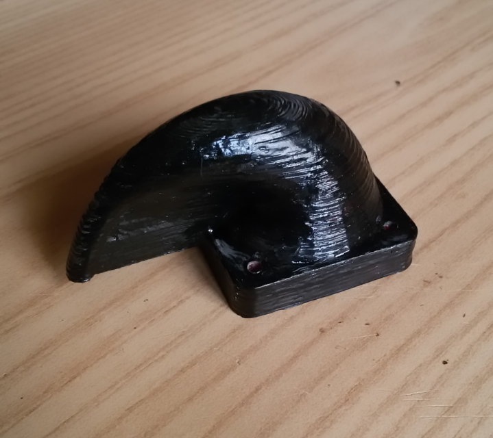

My PLA/ABS cooler😊 Originally shared by Valerio Baldereschi Condotto di raffreddamento per PLA/ABS...
My PLA/ABS cooler😊
Condotto di raffreddamento per PLA/ABS… non è venuto come avrei sperato, ma vabbò è ancora infase di test😄
  1. Painted or multi-color?
  2. What modeling tool did you use?
  3. Cooling for PLA, but cooling ABS makes warping worse.
@Dale_Dunn HI Dale!
PLA object painted with black ABS.
Printed with a Ctc prusa i3 clone. for a few dollars.
I’m testing it on PLA filament but in the near future i will change it to ABS.
I thin k that ABS cooling is good vs bridges parts (but I’m not sure).
What you think about it? You use it?
Painted with ABS. Interesting.
It might help with bridging in ABS. I never used a cooling fan for any part of ABS printing, because I didn’t have a cooling fan last time I worked with ABS.
Most fans have very little pressure and may not ultimately blow much volume through there. Does it work?
@Matt_Harrington Unfortunately not as expected. I’m making now one with a larger end hole.
A squirrel cage would have a lot more pressure. Maybe it would work better?
@Matt_Harrington what kind of squirrel cage?
Aha yea that search term looks confusing. They are also called blowers and come in standard sizes. Here is an example: https://m.newegg.com/products/9SIAAES4WW2284
Note that the air comes out the edge and that they make a lot of noise but they have much better pressure. People sometimes put little nozzles on the output and just attach it near the extruded tip.
@Matt_Harrington Hello Matt. The blowers you suggest is very good but in my case i bought a lot of low cost 40mm fans an id like to use it for my project. As you suggested my version of blower as a bad efficiency, so i decided to do another improved version with a bigger end hole… and this time it work very well!
