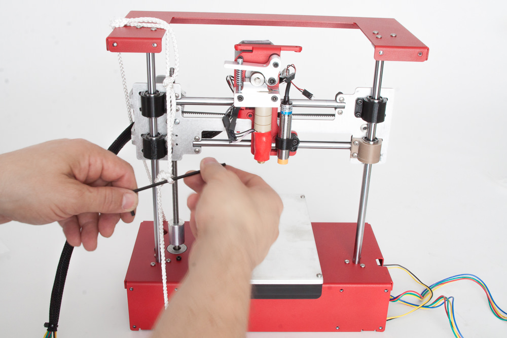

My Play is built and powers up. Cura support and calibration to follow after the 3D Print show today. I’m very impressed @Brook_Drumm , it’s a well thought out design and very easy to construct. Lots of photos taken, which I’ve whittled down to 144. Here’s one contribution to the build process, getting the Z rods into the end supports. With an extremely tight fit I didn’t want to start hitting it with a hammer, risk bending or scratching anything. This was my solution, all that’s needed is a length of strong cord and the big hex key you ship.
