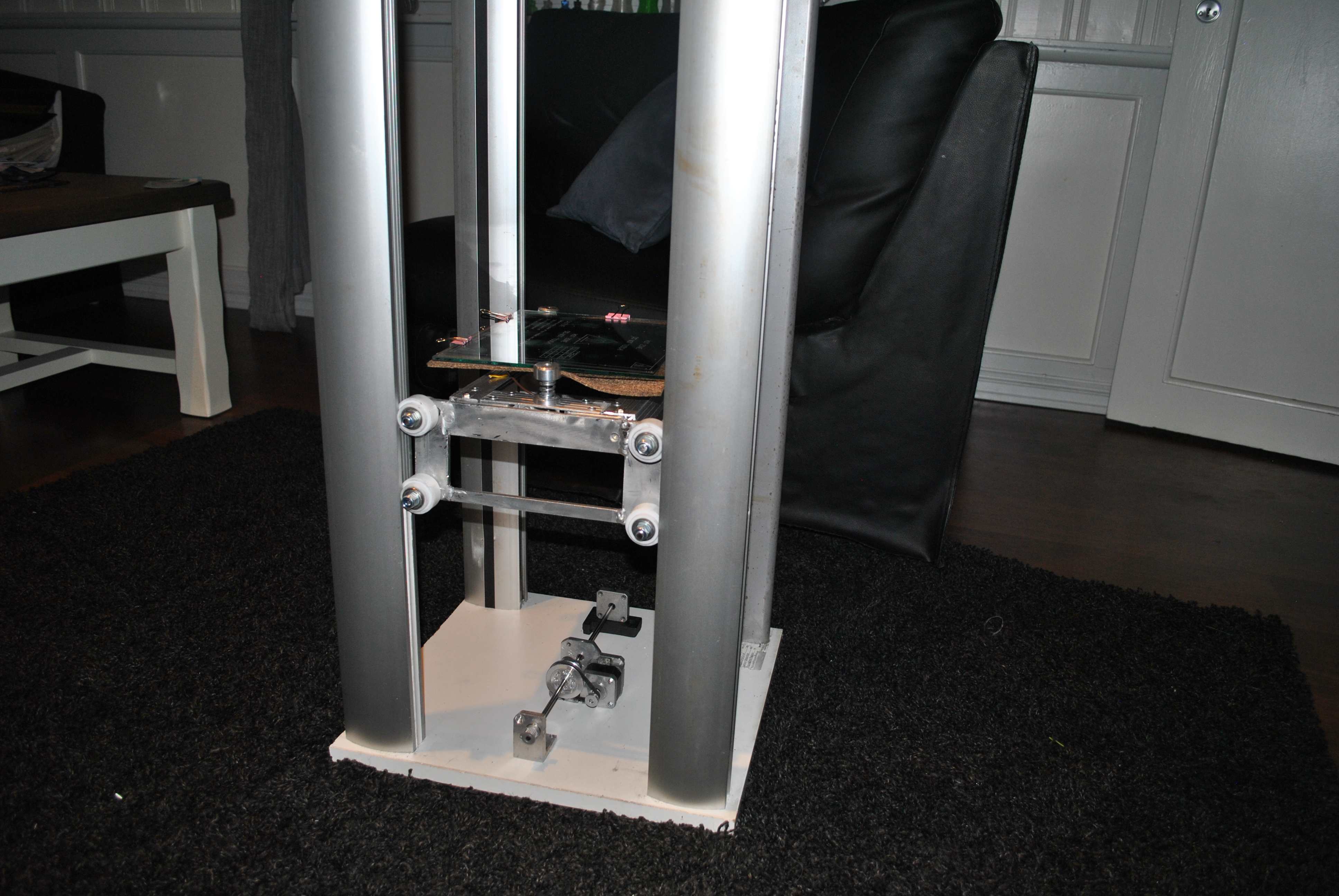

My portable printer getting more Z height and are not as portable anymore.
New build volume is 220x220x1300mm
Expect to be finished in about a week if all goes as planned

@Nelis_Willers I build it so high because the aluminum profiles that someone had thrown in the trash had this length. You would not print an object at 1300mm in ABS but with large nozzles (1-1.5mm) and thick layers (0.8-1.3mm) printing PETG or PLA 1m objects like for example sculptures and vases will be ok. For things that need strength, I have another printer.
