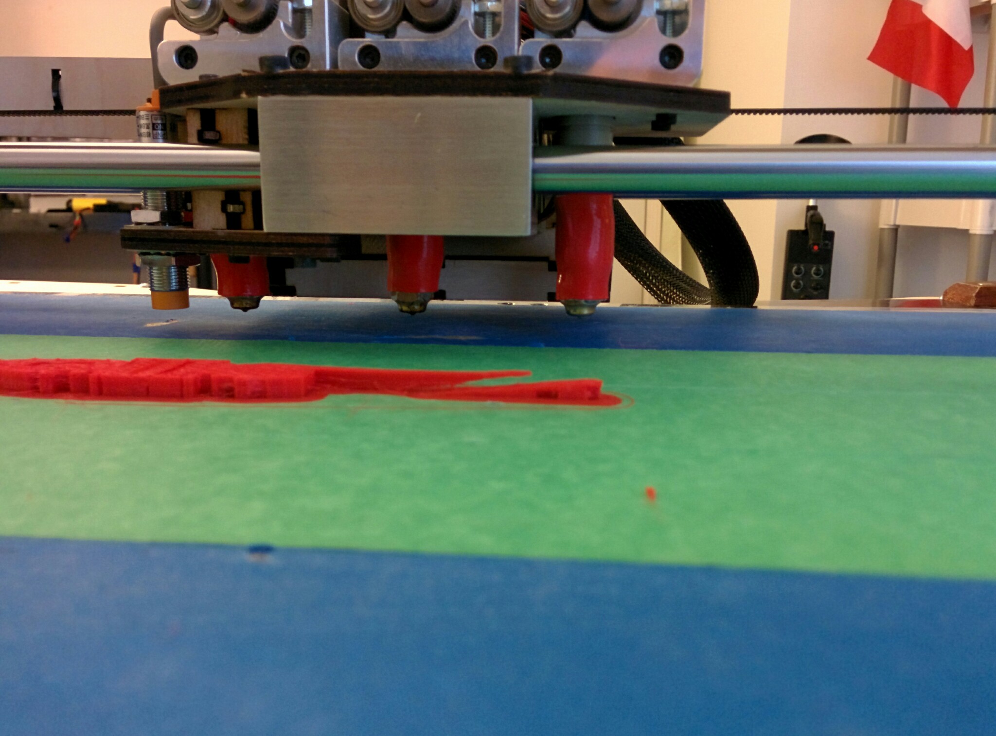

My print is peeling off the support. I’m using Slic3r with 0 interface layers, pattern spacing of 1.5mm, and interface pattern spacing of 0.4mm. I don’t know what I’m doing wrong… Does anyone have advice?
This where heat beds come handy I guess…
What material are you printing in, PLA?
PLA. In the photo, you see a gap in the print. The print is not sticking to the support, and stresses are deforming the part when each layer cools.
Alright, you might need to up the temp a bit. In print PLA at 197 C. I think you’re printing too cold so the layers aren’t adhering to the supports. I also have only had success printing PLA on blue Painters tape. The green tape doesn’t seem to hold for some reason. I also usually have to put down a new layer of blue tape after each print. Finally, your bed might be slightly off level so do a quick check of level at the six points around the perimeter of the bed. Let us know if you figure it out, and good luck!

Set initial layer to .2 mm and 10mm/s speed if it still lifts try purple school glue sticks works like a charm
- Yes, like what Steven said, up the temp a bit & ensure level bed. My usual temp for PLA: 220 Deg. C.
My print bed is laid with Kapton. - Try cleaning the bed with acetone or hot water (I usually clean with hot water).

What’s the ratio of your extrusion width to layer thickness?
“Leveling is important but that is is only step one. Step two would be to adjust the Z offset in the slicer. You can have a perfectly level bed but if your starting to close or to far your going to have issues. It helps to have the hotend hot also, if the nozzle has a bit of plastic stuck to it then that will change the height that you level it at. The Z offset value is unique to your printer and the way you leveled your bed. Don’t use someone else’s Z offset value.”

Increasing the temp to 220 was really helpful. Thanks for the tips guys.
Actually it was helpful, but problem persists… Weird. It’s like the air gap between the support and the print is too large.

Maybe you are underextruding? Just a guess.
@Peter_Csaki , yes I suspect that too. My filament diameter setting was off by +0.1mm… I don’t know if reducing the filament diameter setting will be helpful… Will let you know.

Actually, adjusting the filament diameter property resolved this problem. I’m also printing my PLA at 220C now. Thanks everyone, this has been helpful.
