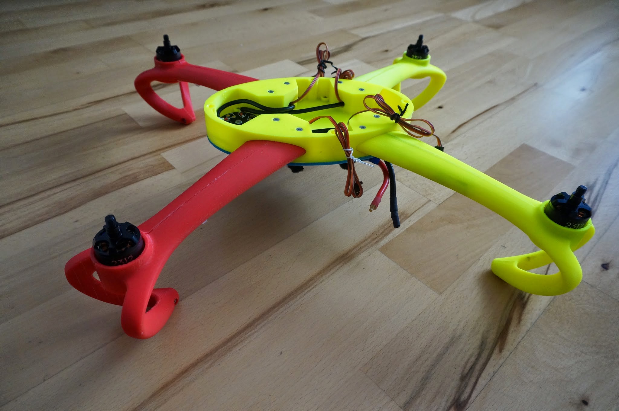

my print of the OpenRC Quadcopter, still work in progress.

thnx :wink: waiting for the Ardupilot now, decided against Naza since i want to keep it OpenSource as much as possible, and Ardupilot has much more possibilities (at least on paper) and its a lot cheaper but probabpy a littel difficult to set up. ill keep you postet how its going …
I love that design… It’s printed on abs or pla?
I would suggest ABS, PLA will deformed when motors get heated.
Its printed in ABS, I put some notes on thingverse how I printed it, and some modifications. Next weekend I may be able to do a first test of the electronics. Let you know how it went…
