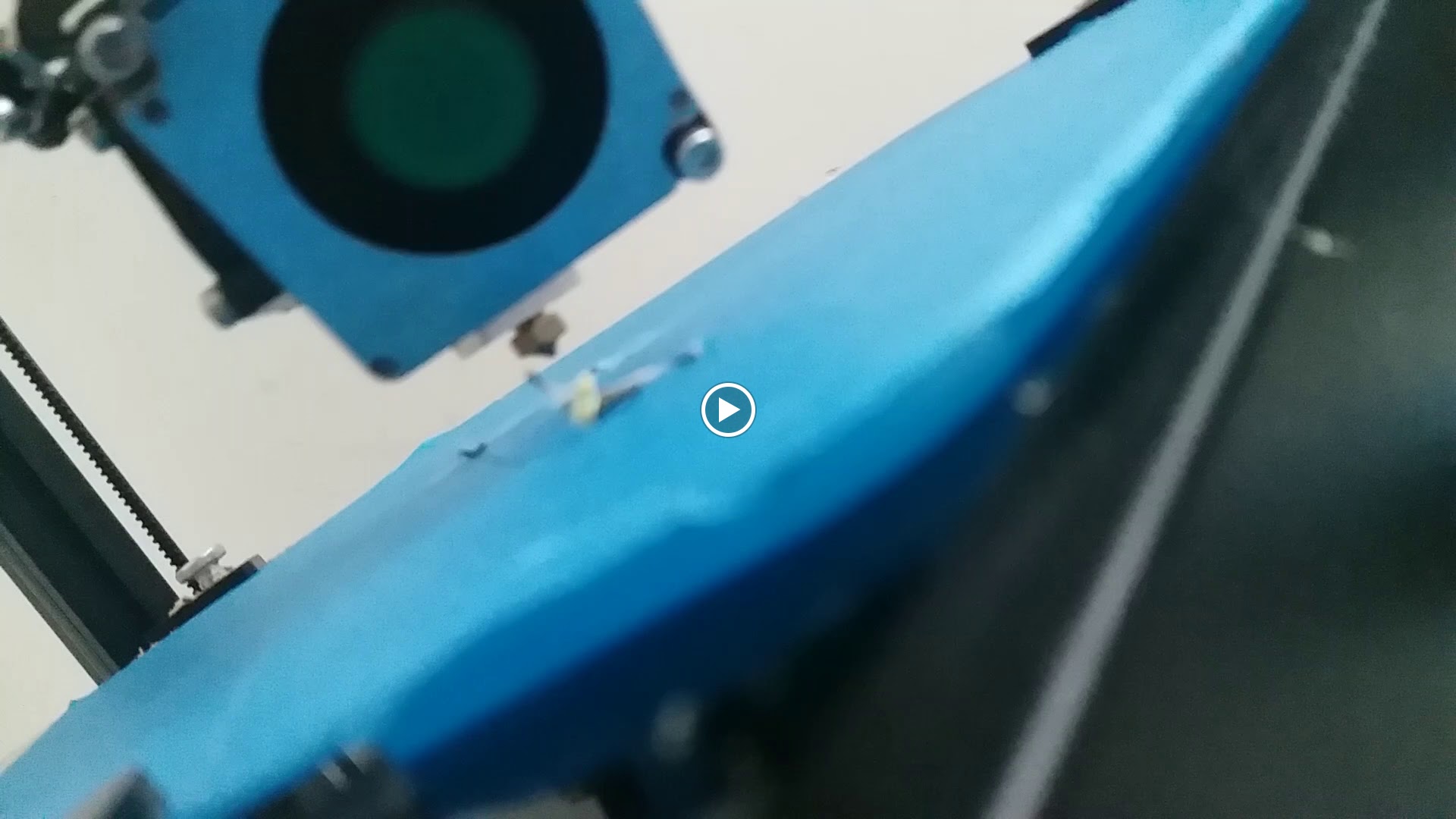

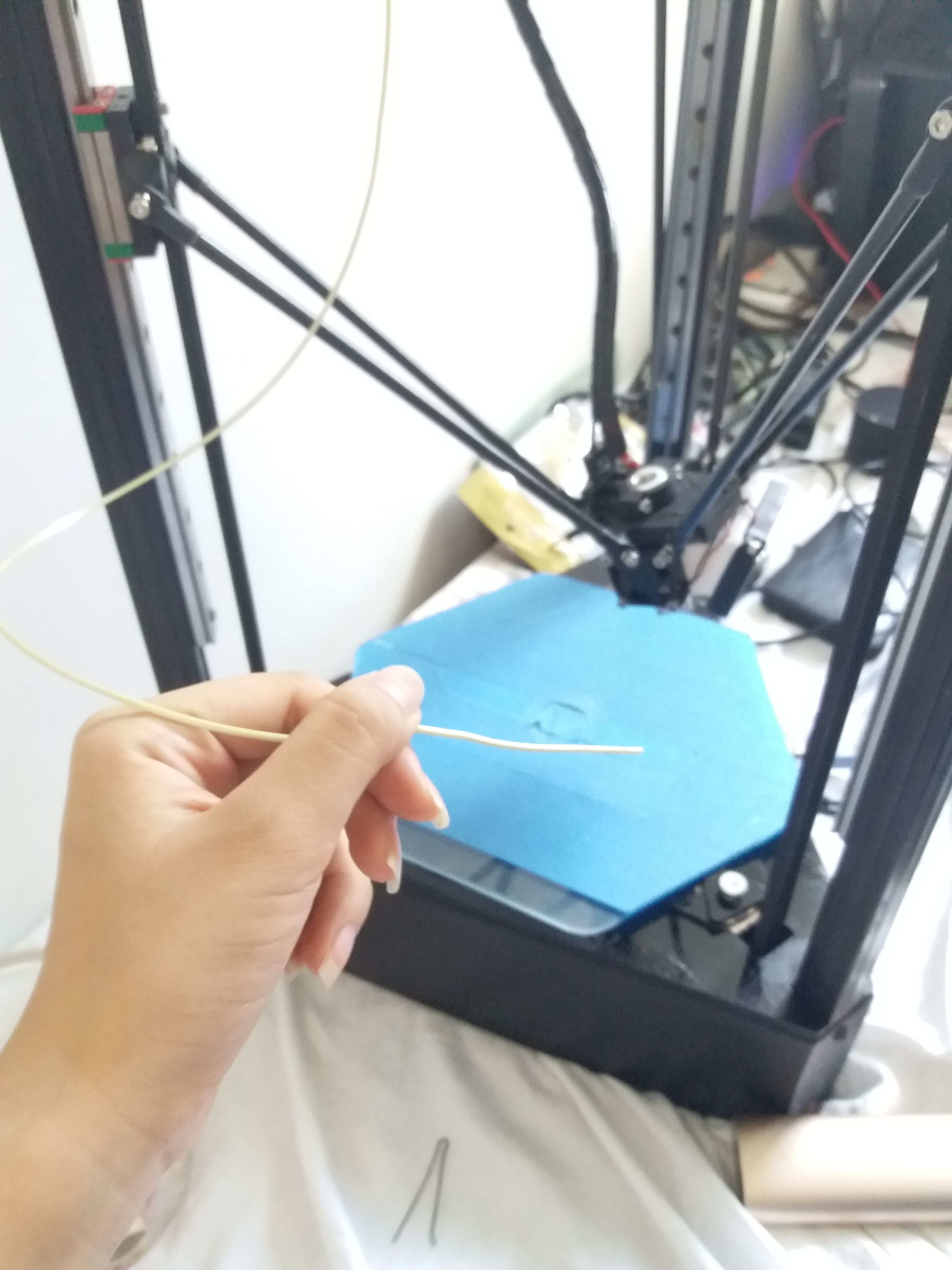

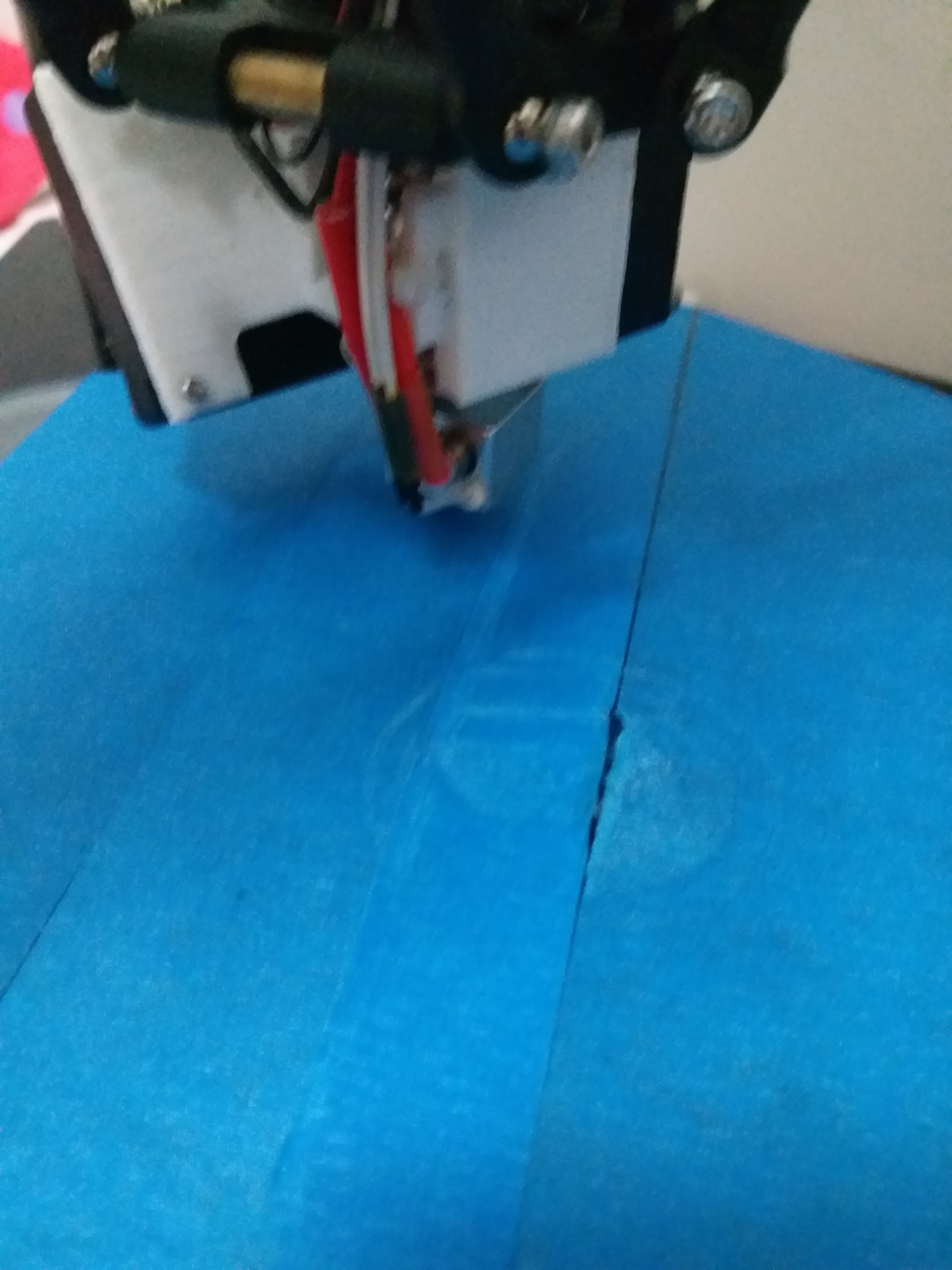

my printer function but it can’t outflow the material. The temparature show that the printer has reached about 200C but obviously the material didn’t melt so what should I do to solve it ? Does it need to set up any certain parameters or is there something wrong I didn’t pay attention to ?

@whackyhack no,this may not be the problem of filament moving cause I push a lot and the printer split a little then it didn’t split anymore
