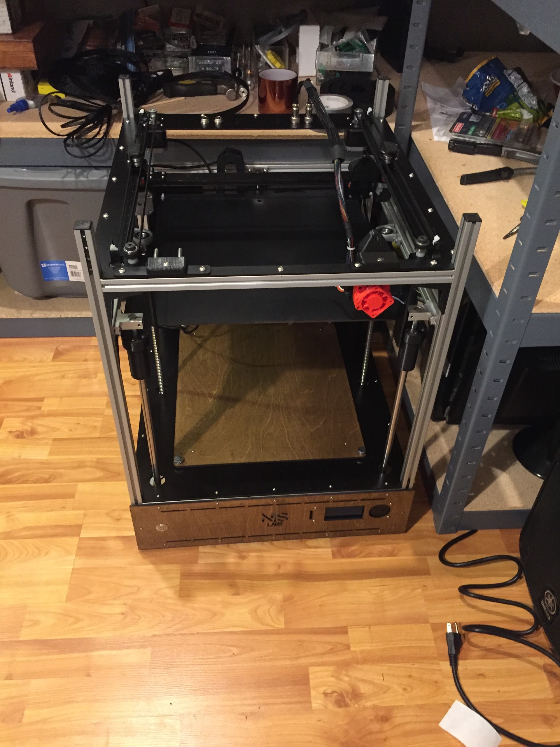

My printer is going to run on a Ramps 1.4 with Marlin 1.1.5.
My printer is going to run on a Ramps 1.4 with Marlin 1.1.5. I need to add movements to the boot sequence. How can I make the printer home and move as soon as the printer is turned on? (most forums say its possible but do not say how.)

Thanks for the response, but I need to do it on powering on the printer. The reason is is that my Z probes are mounted to the tool heads, and by default, the tool heads are not attached to the X/Y carriage. When I home, the X/Y will home and the Z Axis will crash because the tool head is not over the bed. I need the printer to pick up a tool head as soon as the printer is turned on, or make the Z axis unable to home until the printer knows that there is a tool head attached to the carriage.
