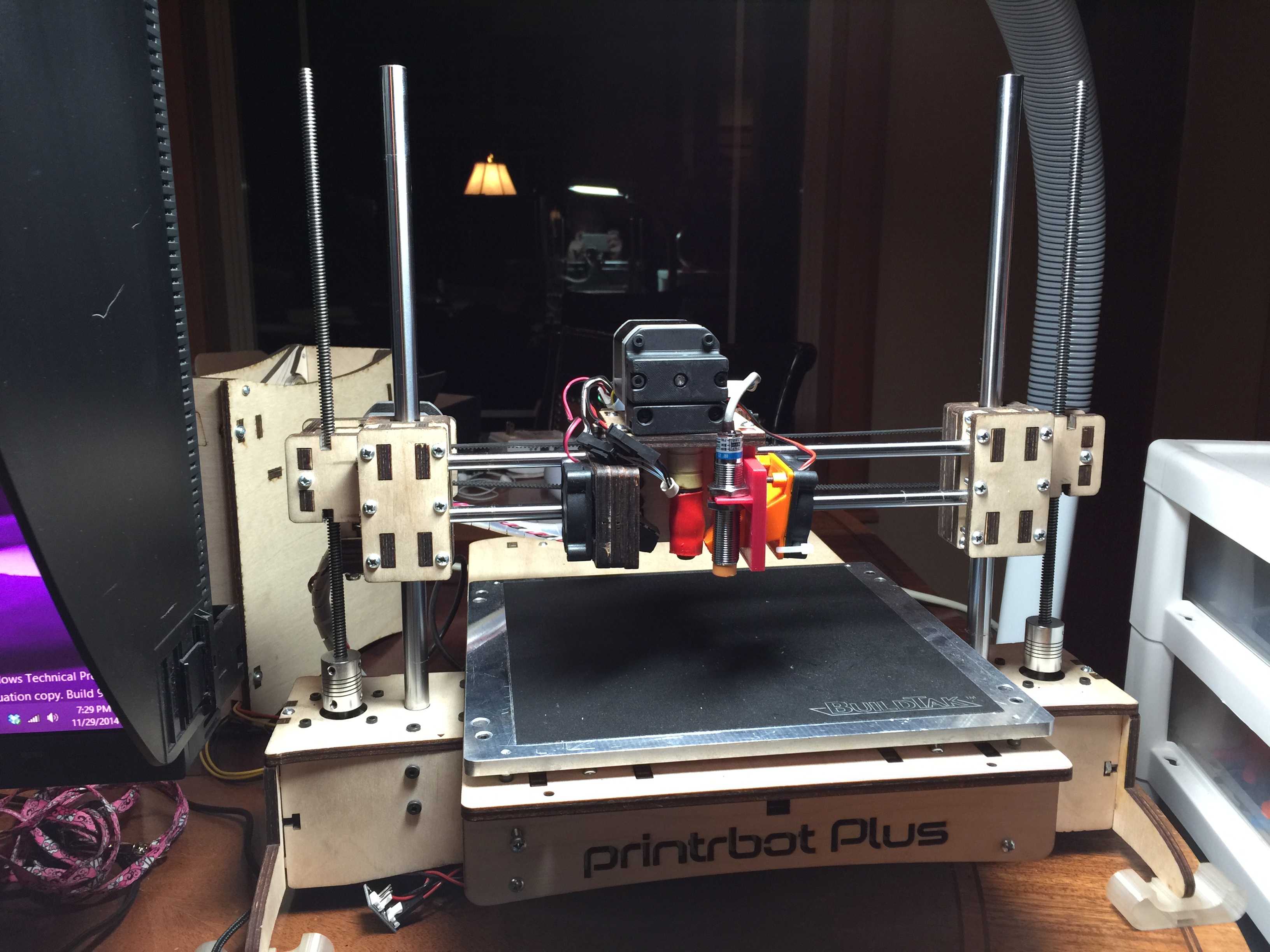

My Printer shall print again!! (Evil laugh here) Now I'm just waiting for my
My Printer shall print again!! (Evil laugh here) Now I’m just waiting for my metal Ubis.

I have a Rev. F board and the sensor just plugs right in. The Firmware is Lassen. My sensor is still not working 100% but it goes to the center and homes there. I’m still working out some kinks.
