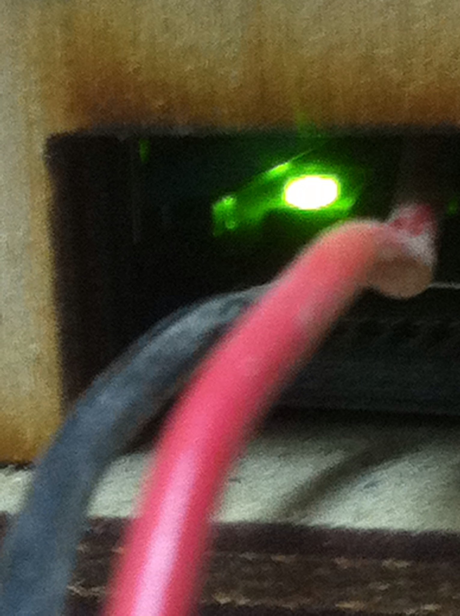

When the power cord is plugged in, I CAN see a green light on, within the electronics housing. So there’s some power there? Help!!!
