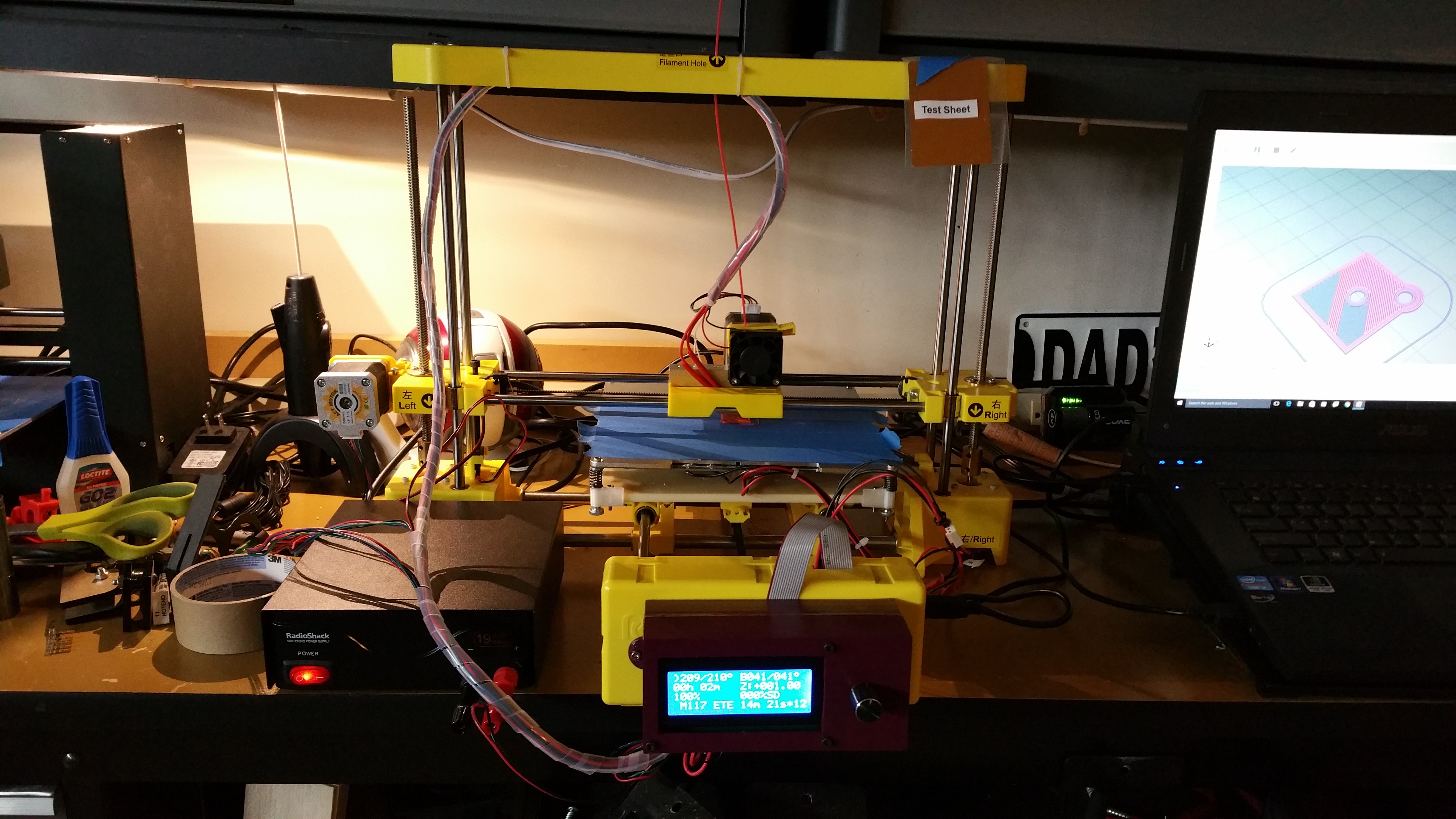

My PrintRite DIY printer modified yet again to use an all aluminum heatbed arrangement
My PrintRite DIY printer modified yet again to use an all aluminum heatbed arrangement with an excellent benchtop power supply. The Thingiverse mod by brkdwn was extended to allow better handling of the bed corners. My supply puts out 14V at 19A. More than enough for the job. Works perfectly even though I lose about 15mm of Z.

You can buy this printer from HobbyKing and there are several printers you can buy from a variety of places. This one has been modified quite a bit so you can’t expect it to be exactly like this coming in.

Do yourself a biiiiiiig favour, if you want this printer to ever be worthwhile, bin the motherboard, ramps1.4 it and swap to a j-head extruder, only then is it truly a worthwhile printer, not baseless opinion btw, you can find mine on thingiverse.

I agree Lee. I am have already printed the JHead stuff from your design, but I want to do a few more things with this as is to prove a point to myself. After that, I am going Smoothie (a mini Remix from Cohesion 3D). I might use one of my spare RAMPS boards or even an MKS, but yeah I am done with closed ecosystems.
cant beat opensource for adaptability, ease of modification, availability community support and probably the most significant… cost lol
