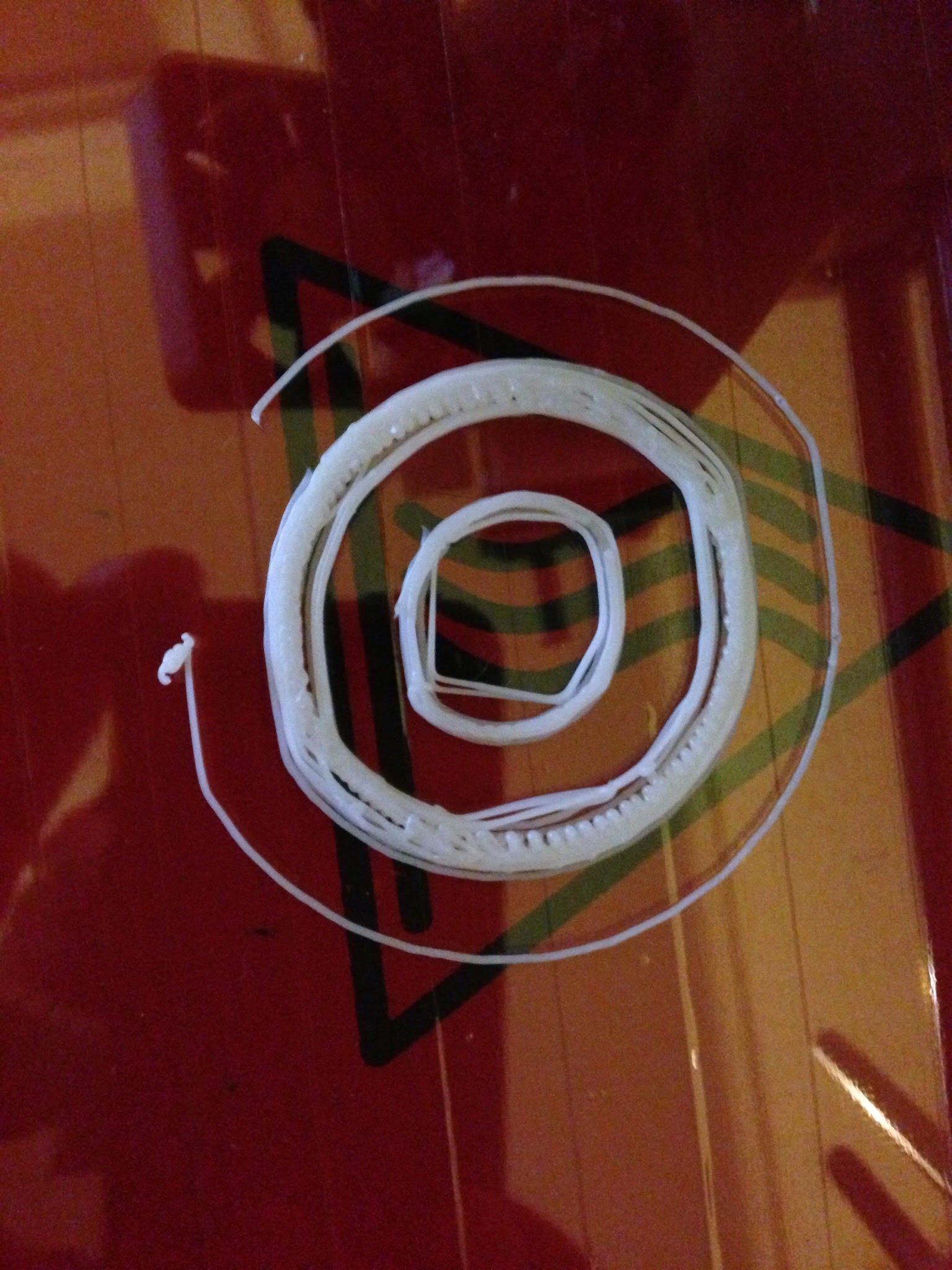

My prints have gone from decent to horrible - original printrbot with bed leveler.
I have noticed these pointed deformations at the top left and bottom right edges. Where do I start? X axis?
My guess would be either really loose belts or the first layer is too high… hard to tell from directly overhead.
Agreed, check your belts and that your gears are not loose on the motors shafts.
Yeah, it looks like first layer adhesion problems. The circles turning into polygons like that tends to mean the filament isn’t sticking to the print bed, so it gets dragged along with the print head for a while, giving you funny shapes like that.
Thanks for all the tips, everyone! Awesome advice. I had already tightened the x axis belt - I made sure that the Y axis belt is nice an tight. @Chris_Horton thanks for that tip - double checked all motor gears, many were loose… Thanks to the tip +Peter van der Walt on looking at those belt clips - they were loose indeed! @Stephen_Baird - I definitely think I need the revisit my extruder calibration for this new batch of filament (and the insane humidity of the north east US right now) - I am trying to sort this x/y weirdness prior to moving on to the extruder and z… does that sound like a good order to go in?
Can I suggest you invest in some locktite? Or, alternately, some cheap nail polish. Paint screws with it, and then tighten them, and they won’t come loose very easily.

Check for loose pulley set screws too. This looks like loose belts / pulleys and a z - endstop screw adjustment.

Hi Brook! Thanks for the tips - I am going to work on the bot tonight - I’ll post my results!
Guys - Thanks again for all the advice! I got some t2.5 belts and pulleys, took apart the whole bot, tightened everything up, used Josef Prusa’s awesome calculator ( http://calculator.josefprusa.cz/ ) and the Printrbot is better than ever!
Bonus: I only had to do the whole calibration process once to get everything working great!
