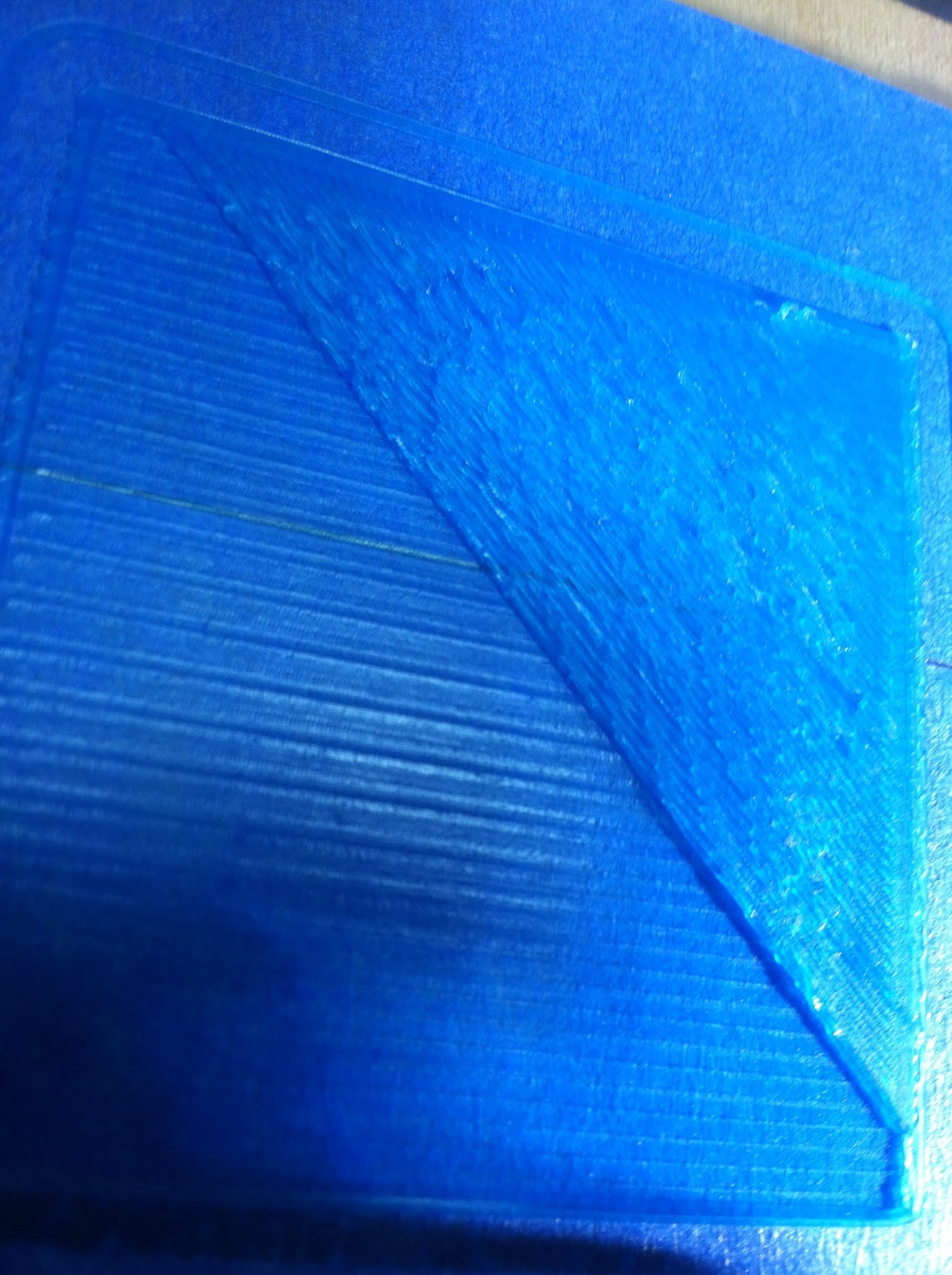

My raft layer will lay down nice and smooth,
My raft layer will lay down nice and smooth, but the actual ‘first layer’ still goes on boogery. Leveling isn’t the issue as over the last week+ I have re leveled many many times and get same result: first layer funky, even with a nice raft underneath . In pursuit of solving this I have tightened belts, tightened everything, taken off and cleaned hobbed bolt, cleaned tip, installed a filament guide, etc.
If you refer to my precious few posts you can see examples. I feel as if I’ve tried everything here. I still have not found a good explanation of the technical/physical differences of a raft and a first layer- I feel like that info might help me get a lil more perspective on my issue. This community has been AWESOME with suggestions and ideas, yet I still can’t get that perfect first layer like I was able to before this started happening.
(My layers look great though, and my circles are more true than ever)
Any ideas? Anybody?: )

I keep coming back to the extrusion- why does a raft lay down nicely but not a first layer?!?

@Nigel_Dickinson . Hi. I think you have helped me before. Thanks. So, I have tried slowing down, even way way down, and I even tried speeding up, just to see the difference. I have repeatedly tried the same prints at 100% flow and 90% and all inbetween. Last night I took off the gears and took out the hobbed bolt, cleaned well, replaced everything tightly. I can visually watch 20-30mm extrusion(manually), and it goes smoothly and uninterrupted. That’s what’s getting me- everything that I have learned and tht has worked in getting good prints up to this point is not helping now. Tweaking this, adjusting that. Etc.
@Ashley_Webster . Yep. I’ve tried with different first layer settings in slicer. From 200% to 100% and several inbetweens:(

So why would a raft layer extrude and lay down fine, while a first layer wouldn’t, under exact same conditions?!? Assuming the bed IS level. If my issue is extrusion, which I am leaning towards, why WOULDN’T it be apparent in the raft layer?
If I am seeing correctly raft layer passes are more spaced out. On the first layer your print head makes printing strokes and each stroke is slithgly over the other. I believe if your print head is too close to the bed that second stroke over last one pushes semi-dry plastic against the bed and causes some warping/unsticking. Reducing the pressure between the extruder tip and your “last stroke” should avoid this. That is at least my deduction at least.
@Francis_Courchesne thanks for that explanation, worded that way. Helpful way for me to look at it and consider. Ah, how the brain works! About to try 1more round- if it persists I am taking lots apart*
