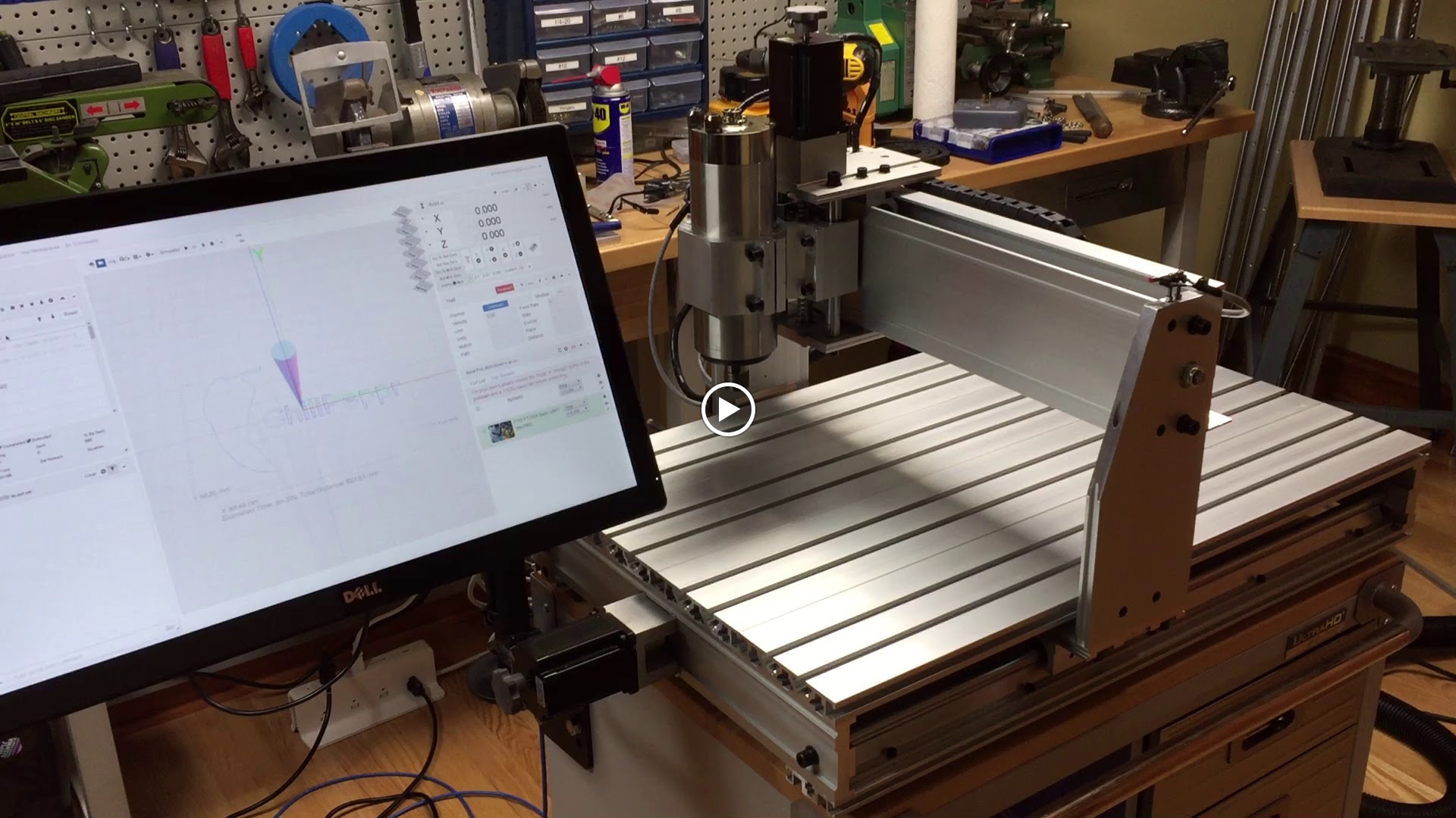

My RaspberryPi 3 powered 6040 is alive! It homes, but unable to just press play on the gcode. I’m guessing it’s due to the z axis being homed and not touch z-plate’d. Now I need to review the chilipeppr intro videos
Wow, almost an industrial workstation look and feel. Have you tried the macros to make big buttons and huge freedhold button?
Looking awesome! I agree with Steve that you should make those buttons bigger. That’s scary watching you try to hit the home button, but maybe instead hitting “Go to Machine Zero”. There’s macros I added that show how to change button sizes. You can make that a startup macro to customize. It feels like you should make all your important buttons have a 2nd copy on the right side of the screen where you can hold your hand against the screen and hit with your thumb.
