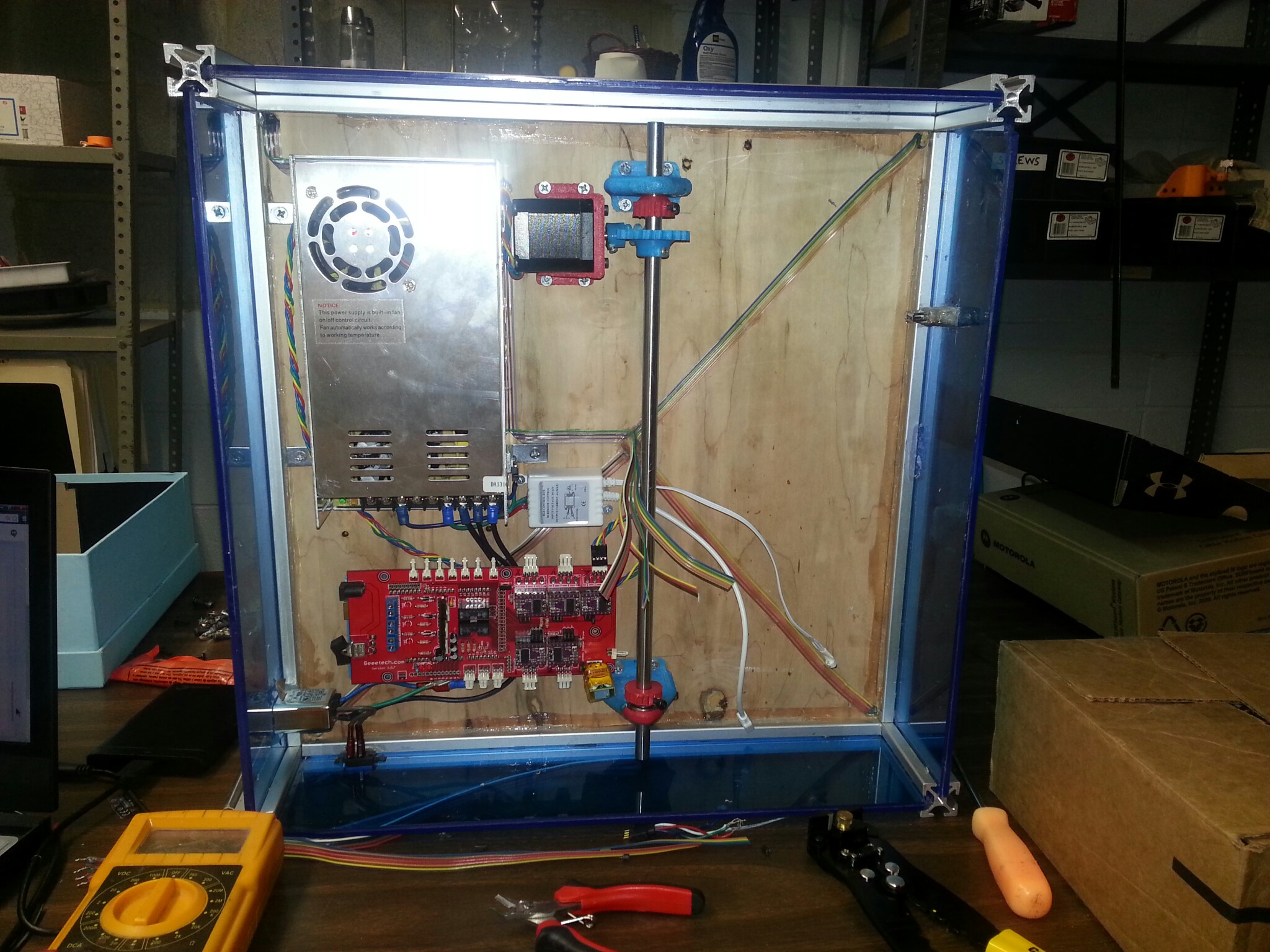

My revised electronics cabinet. The ribbon cable is the wiring for my RGB led strips

Is that the board +Thomas Sanladerer just reviewed?
Will you be adding any under-platform cooling?
@Dale_Dunn no its a geeetech um 1.5.7 board he reviewed the melzi. I think that is what @nophead uses though I’m not sure if it is geeetech or not. I repaired the sainsmart 1.5.7 board and have a replacement on the way. for future builds. that huge switching regulator is variable. I will be using a gadgets 3d controller lcd. The lm7812 I removed is mounted to the side of the power supply (giant heatsink) and dropping 24v to 12v for the led controller (I ordered 24v and they sent 12v) ther refunded most of the money and I made it work.

@Mike_Miller yes I plan on some fans and will probably a forced hot air blower (hair dryer) that blows from the electronics cabinet to the build area. It will be positioned to blow on the bottom of the bed insilation. This will hopefully spread the heat more evenly.

@D_Rob How tall is your electronics enclosure under your printer? Thinking about ordering more extrusion to do a enclosure.
2" between 1" extrusion the panels go between the slots so minus 1 = 3" divider panel to base enclosure panel
@D_Rob Now that you have had a chance to use this, electronics enclosure, design for awhile, how do you like it? I am going to be assembling mine soon and wanted to see what you like and hate about it, before I put mine together. It looks nice, but could be a pain to troubleshoot electrical issues with them mounted like that. At least that is how it looks to me. Is there anything you would change?
This actually is the change I made. Originally I had a access hatch from inside the machine. I have to tip the machine now to access everything but it is now more easily accessible. Also if there is need for full access or total removal of the base it is now easier. There are limitations but I believe the trade off is worth it. With the hatch it was near impossible to install remove mechanical parts like idlers, or the z drive axle. And difficult to adjust the spectra. Now its wide open. the bottom square frame removes with just 4 bolts. And nothing is attached to it to make removal more difficult
