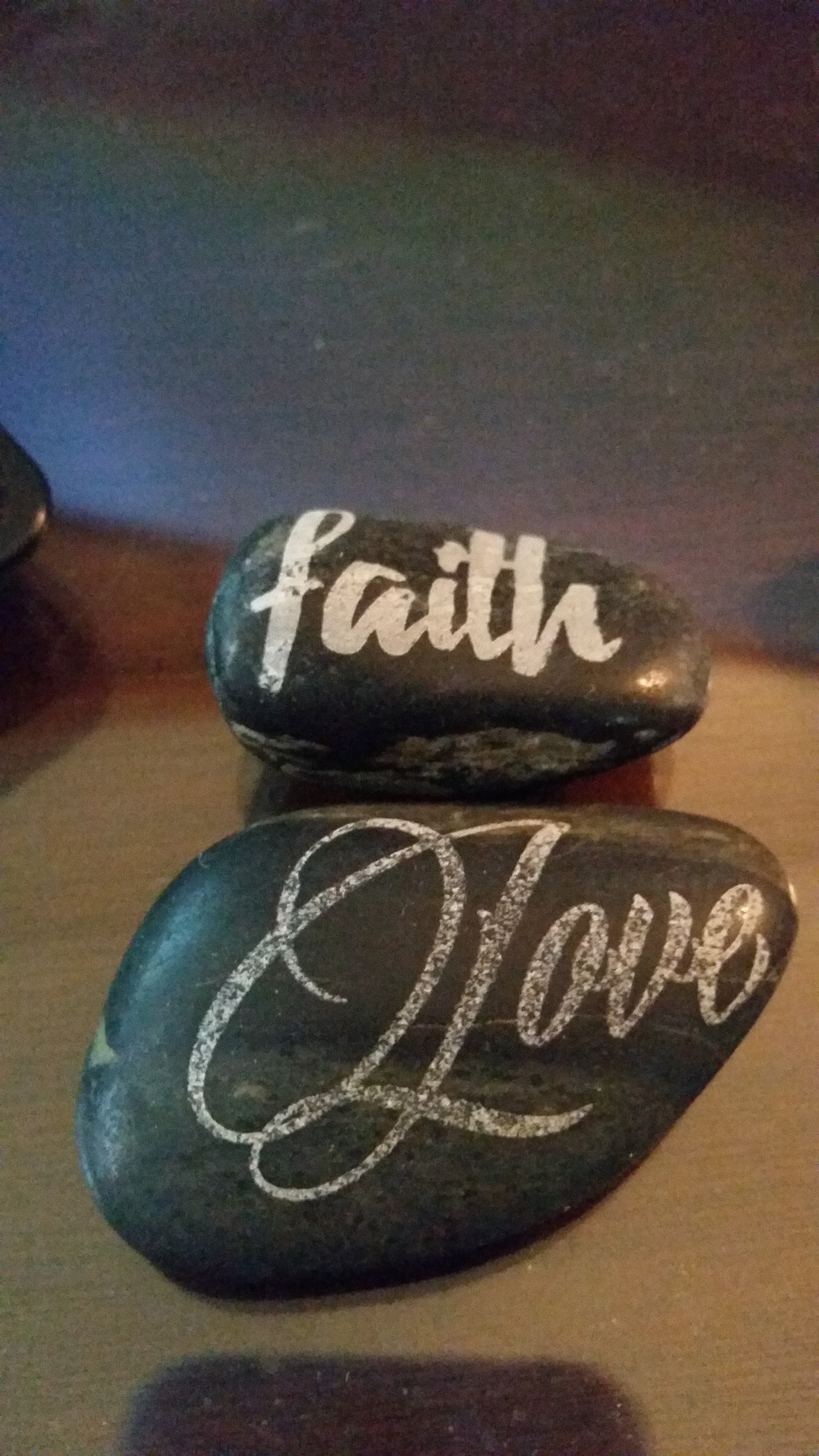

My river rock engraving. Not sure how to post it as a comment.
My river rock engraving. Not sure how to post it as a comment. The lighter rocks don’t work well. You can’t really burn them. Etch bleaching
That’s interesting & looks good. You can’t really post any images as a comment to a post. Unless you paste a link to the image/post. What sort of settings did you use to achieve this result?
@Yuusuf_Sallahuddin_Y very low setting. Maybe 5-10%. And probably 400mms. I went over it a few times. I tried drilling s hole too. Got about 1/4 inch deep cutting same circle over and again. The rock glowed red. Then simply exploded so I do not recommend going too high on power.
@Ben_Walker ​ That is a point I failed to make in another thread about marking rocks. You can’t really cut rock with a 40w laser and overheating some kinds of rocks (like sedimentary) that can contain a lot of water which will boil and potentially explode. Marking/etching should be the objective.

@Ben_Walker Thanks Ben. I actually laughed about the rock exploding. I think drilling a hole would be easier with traditional methods (e.g. a drill & some water to cool it as you go). But I do like the idea of etching/marking the rock/stone.
