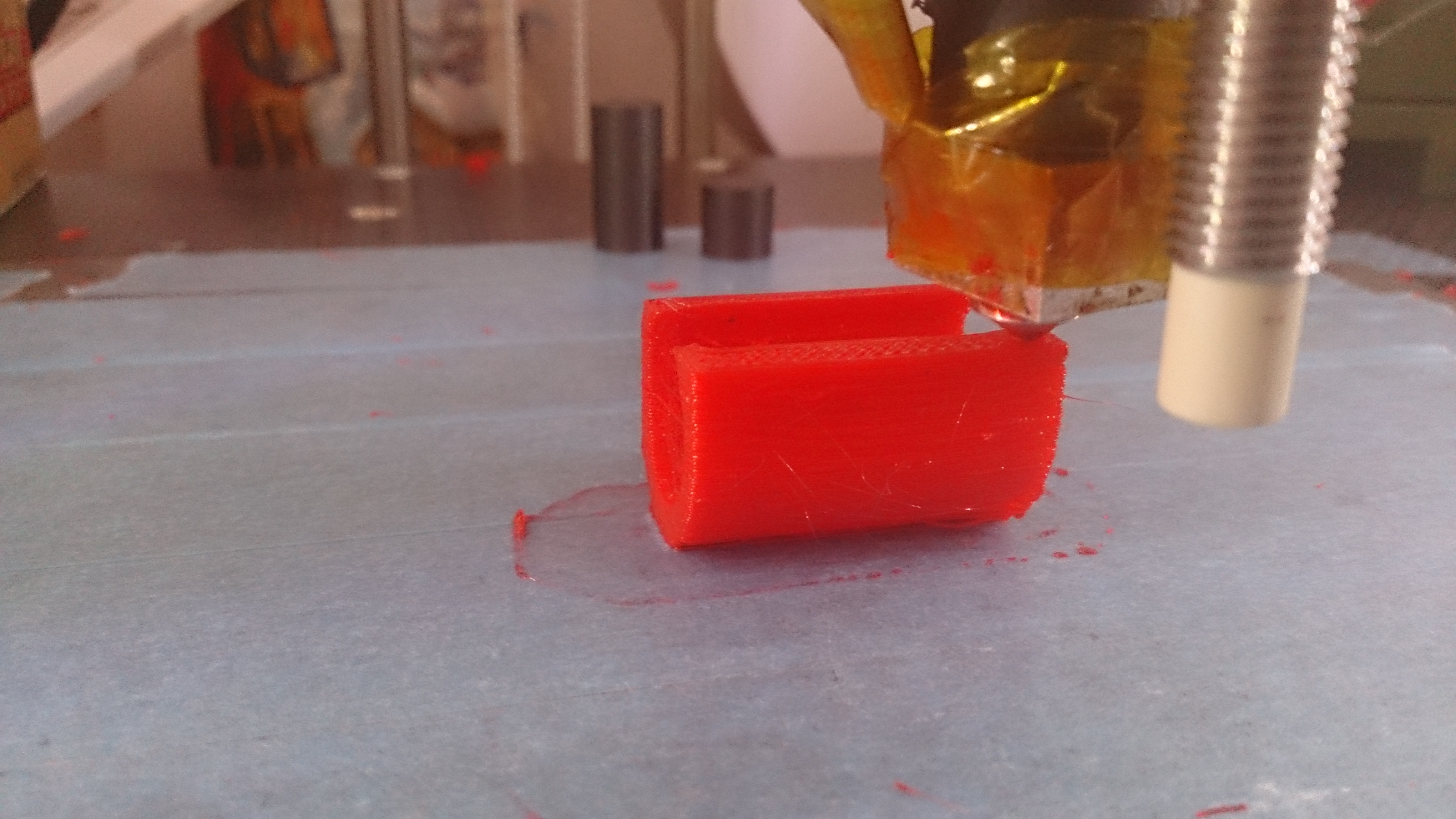

My Rostock is finally printing in a good manner.
After a heck of tuning, modding and adjustments he’s printing part after part.
The best idea for me was to install a initiator for bed leveling. With this and a probing g-code it was quite easy to adjust the level and delta radius. The Autobed leveling is unfortunately not working till now.
Layer 0.2 PLA
Airtripper with J-head
Currently he’s printing parts for a Tantillus with extended build area.
Greetings from germany
