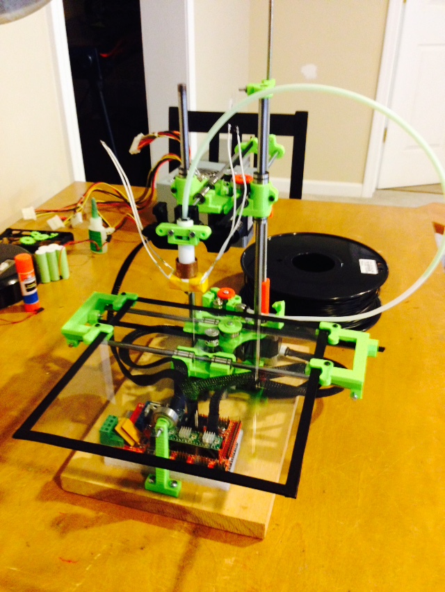

My scratch built reprap smartrap 3d printer is so close to being done!! Just
My scratch built reprap smartrap 3d printer is so close to being done!! Just waiting on a power supply and I have to wire up my end stops and hotend. Then it’s good to go!!!
I decided to put a mesh covering on the motor wires as it is more aesthetically pleasing. It’s super simple to do and in my opinion makes for a cleaner setup. Just have to zip tie them down from getting stuck in the bed while it is moving.
It will hopefully be printing by then end of the week!! Stay posted!!

wonderful work griffin. I like the mesh too :slight_smile: I should try to find some…it’s definitely more clean.
you can cut the M5 thread Z now :slight_smile: haha

Yes @Guy_Bailey definitely build one. It’s a super easy build. My main suggestion is that you run 6mm smooth rod on the x and y axis. That way it will keep the light. The other thing is that if you shop around for parts you can build one really cheap. Mine is around $270 all in (US dollars). Just ran a drawing and I will start to print tonight or tomorrow morning.

The mesh came from http://hobbyking.com. I believe it was only 50cents a meter and yes it works amazing!! I am really for a clean setup and once I get it working 100% I intend to wrap everything aside from the Bowden tube in mesh. I think it will look nice!

I’ll have to do some measurements. The only thing I think that would be tight is the x axis base. I’ll measure it up and let you know. I think it would fit. And if not I’d be happy to print you one haha!!!
cool griffin. I will look for that… love the look :slight_smile: If you see it on our kits, you will certainly laugh .
Actually, Guy, the plates are more around 160x160… I’m affraid you will need to take separate models and build plates with that … or cut plates ? I’ve never tried that.

If the base plate is the largest part in the kit I should be good. I had to rotate it 45 degrees about the Z axis to make it fit in my build area but I think it will work.
Yes the x base is the biggest part. Just measured it and I agree.
