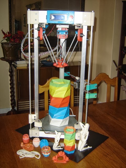

My second delta Electronics in the top box(Rumba) Heated bed - 4 mm aluminium
My second delta
Heated bed - 4 mm aluminium with 3 x PTC ceramic heaters (120 degrees Celsius )
Carriages driven by Spectra fishing line
Magnetic links on the delta arms
25 x 25 x 3 mm aluminium angle towers
Corners 10 mm aluminium tubing
Boxes at bottom and top - 3 mm composite aluminium sheeting
Water cooled all metal hotend
Autolevel implementation with magnets and hotend
2 Bearing filament feeder
Al prints homemade ABS (Vase on the printer 300 mm high)
http://deltaprinter.co.za
nice!!!.What are you using to extrude filament, a lymans, filastruder, a home made extruder?
A home made extruder - http://deltaprinter.co.za/filamentextruder/index.html
Great googly moogly…
! What kind of volume do you have for printing?
200 mm diameter cylinder 350 mm high or 200 mm diameter cone maximum 400 mm high - (Vase on the printer 150mm OD 300 mm high)
