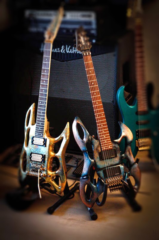

My second self designed 3D printed guitar body.
My second self designed 3D printed guitar body. This time I used my own Ultimaker 2 instead of Shapeways. Because of the small build size I had to print the body in parts. This was a test to see if it was possible to print a guitar body on a home 3D printer…

@Michael_Williams you don’t have a problem with string tension bending the body?

@Michael_Spano_Jr_Ama the one at the left has a wooden center core so no problems at all , the other one has a honeycomb structure inside. Time will tell if this one will hold. Stay tuned ! :slight_smile:
@Chuck_Stewart thanks Chuck! here is a link for the one at the left https://www.youtube.com/watch?v=uD9OwuDkq6E
In 2 or 3 weeks I’ll upload a video from the other one when I’m back from traveling.
