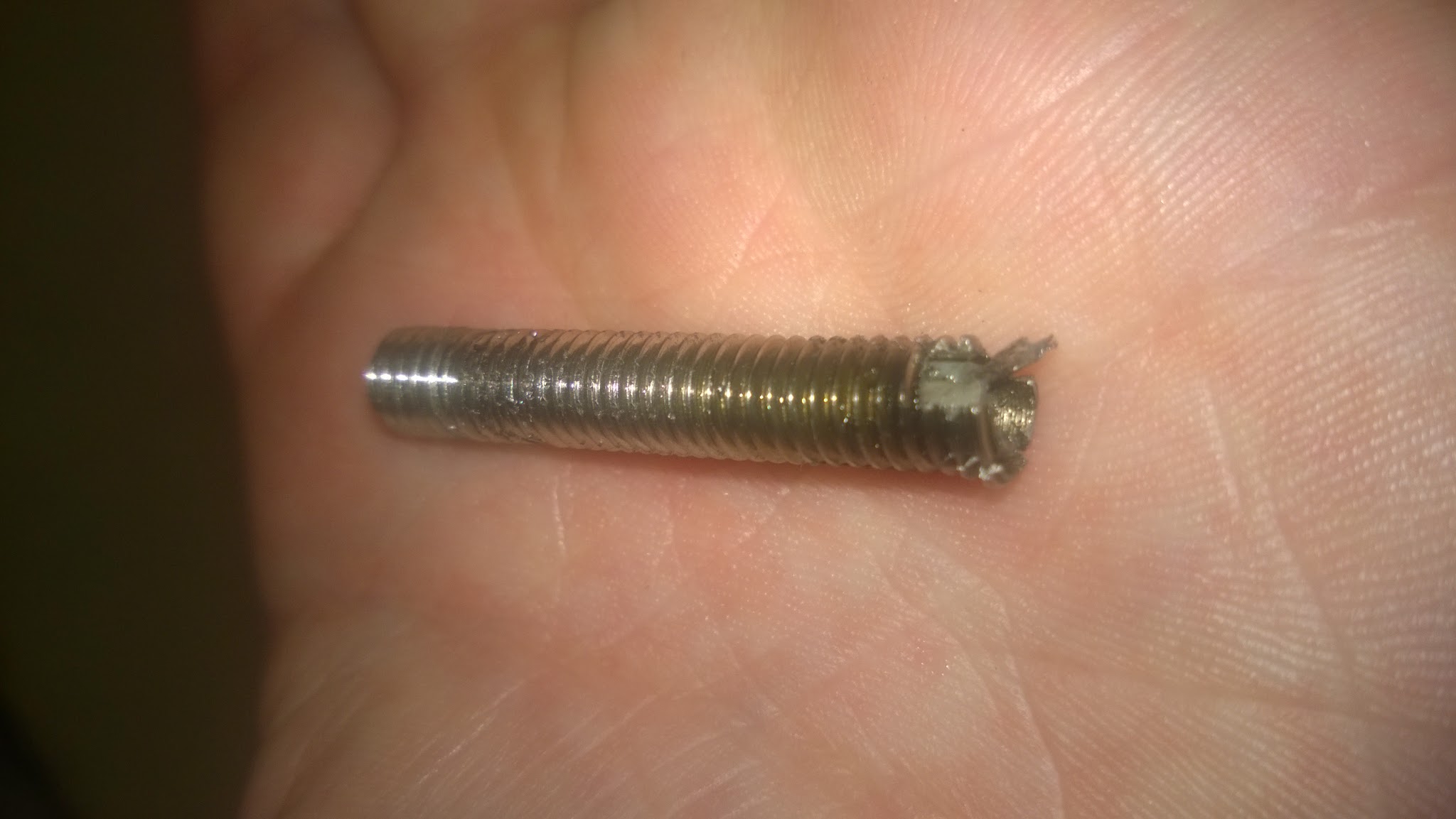

My shaft is broke I ordered one on it's way I have to wait
My shaft is broke I ordered one on it’s way I have to wait now about 3 weeks for replacement. So Printer down under maintenance…

Is that just a threaded rod?
No it’s not just a threaded rod it’s the Extruder shaft. It has a few different diameters and a inner seal.
It’s just a long screw or threaded rod. You ought to be able to source something similar enough at a hardware store. For example, “quarter inch by 20, fine.”

@Michael_Rainey No it’s not “just a threaded rod” Also of course it’s metric! M6 1.0
@Scottie_D369 Of course it is. American measurements for the incompatibility. And of course it isn’t just threaded rod. That would be too easy. If it were just a part you could pick up at any old hardware store you wouldn’t be locked into their supply chain for regular maintenance, would you?!

Well there’s a guide for the filament inside of it. Have any of you ever seen this part?

So, theoretically, you should be able to buy an appropriate length M6 1.0 stainless steel threaded rod (or a bolt). Then, use a drill press to drill the narrow diameter all the way through. Follow the narrow hole with the larger drill bit for the Teflon tube (it’s usually just a step).
Of course, stainless is tough to work, and this would require a really good drill press and vise, at a minimum…
@Carlton_Dodd Have you ever tried that? Because a nice strong vice will I guarantee it ruin the threads doing that. Then you have to re try and attempt the tap it to fix it and becomes another bigger mess. That’s how I got it this far on this piece.

This all started when I had a problem it leaking there were seeps of plastic bubbling up from the nut. I was able to seal it up good where it wasn’t leaking on parts. But was still there. But I was getting a clog inside after every print. I was able to fix it each time but that’s time consuming so I thought to take it apart and fix this issue so then it broke completely. So I would be still printing right now if I just pushed out my clog like I have been. Either way I kinda needed one anyways I just pushed it. (Lesson learned) Don’t take apart yet until it isn’t working. If you found a way that works go with it.
