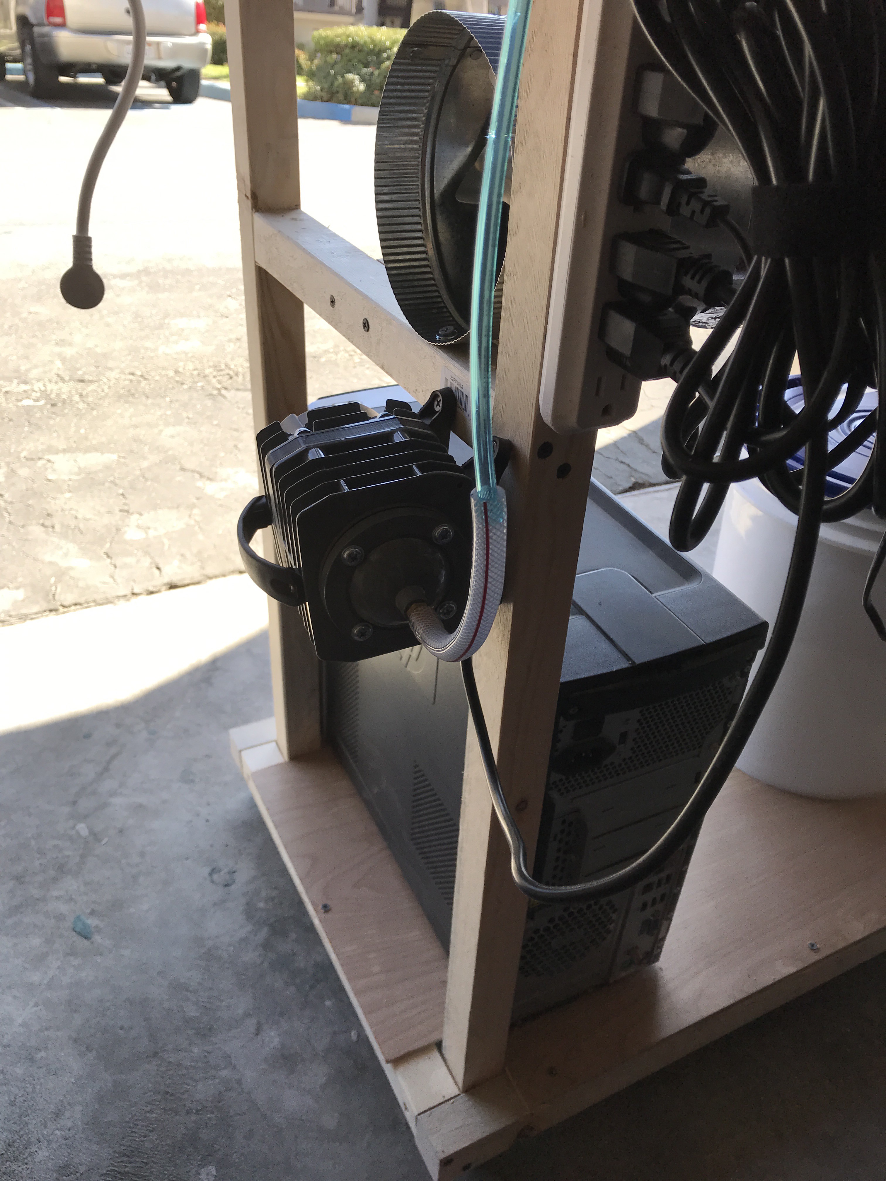

@TheTopheezzy That’s a cool looking tube for the air-assist. Where did you get it? And what is it plugged into? I have a big air-compressor for my air assist, but it’s sooooooooo loud, neighbours get upset when I am using it.
I bought everything over 2 years ago and I don’t remember any of the names or brands of anything I bought . All I know is I bought it off of eBay
@TheTopheezzy No problems… that looks like a much better airflow pump. I might get something that size. Cheers :slight_smile:
@Seon_Rozenblum it’s so quiet! I mean, you hear it, but it definitely is quiet haha

@Seon_Rozenblum here is the air pump I’ve converted mine to. If you get one watch that you get the right sized one as they have different outputs. I’m happy with 951 gph. I also use this variable switch to control the air output.
