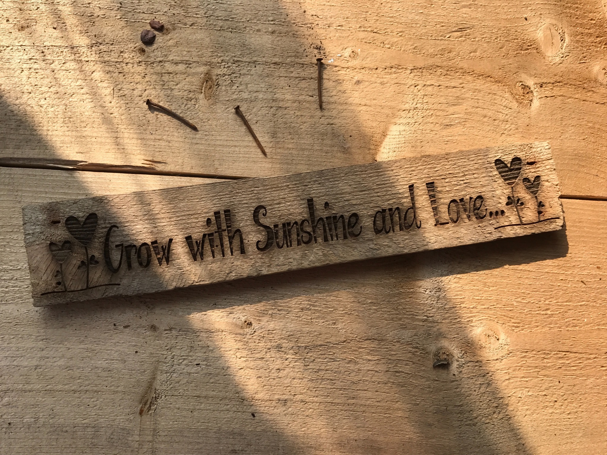

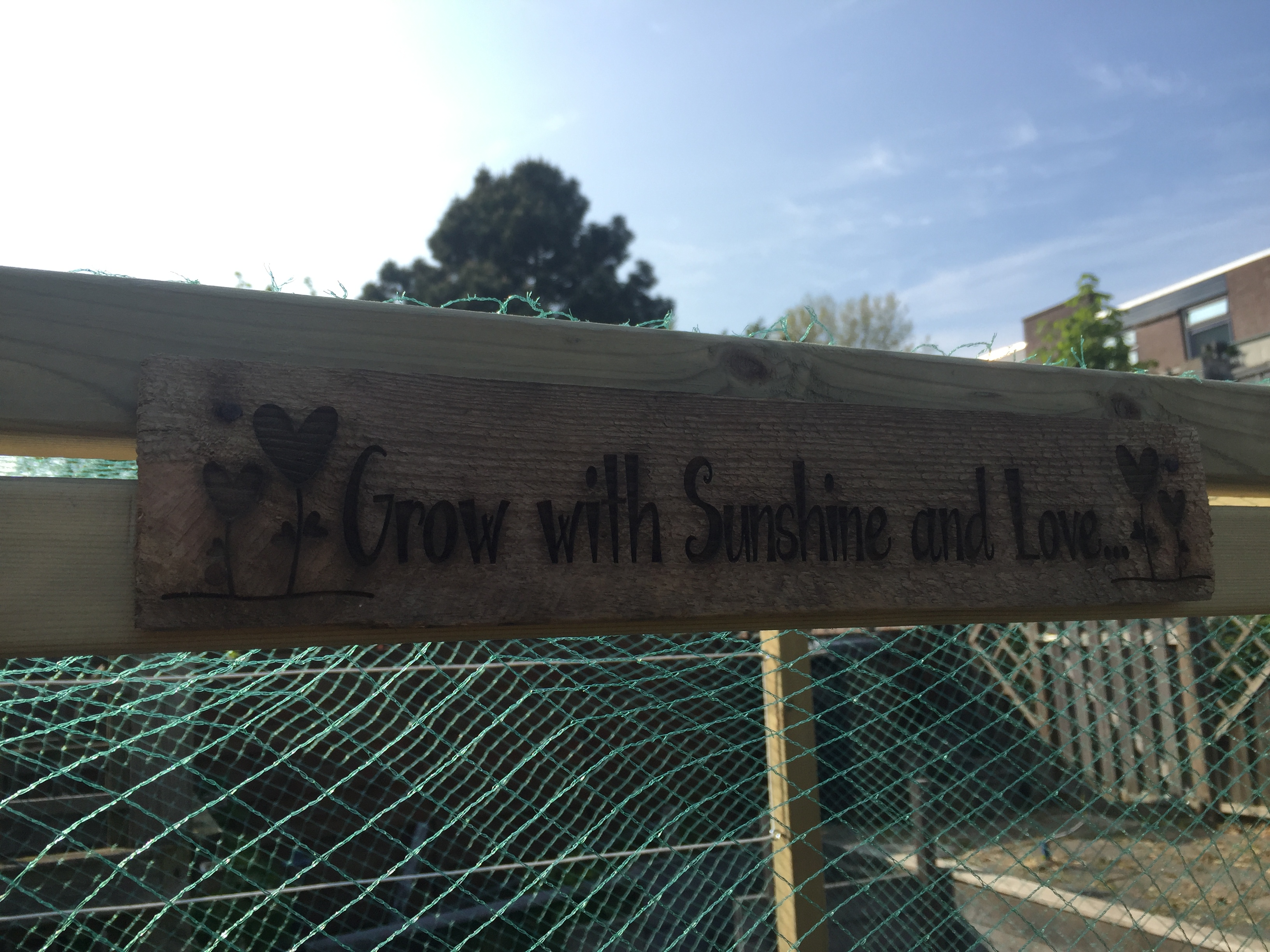

My son has a small vegetable garden, and we just built a bird-protection structure to keep birds away… So it needs a sign to complete it…
This is wood from an old Dutch auction fruit-crate…
https://www.youtube.com/watch?v=xjxATewjdUc
Is that all vector engraving? Should try that … bitmap didnt work too well when i tried last.
Yes, all vector…
