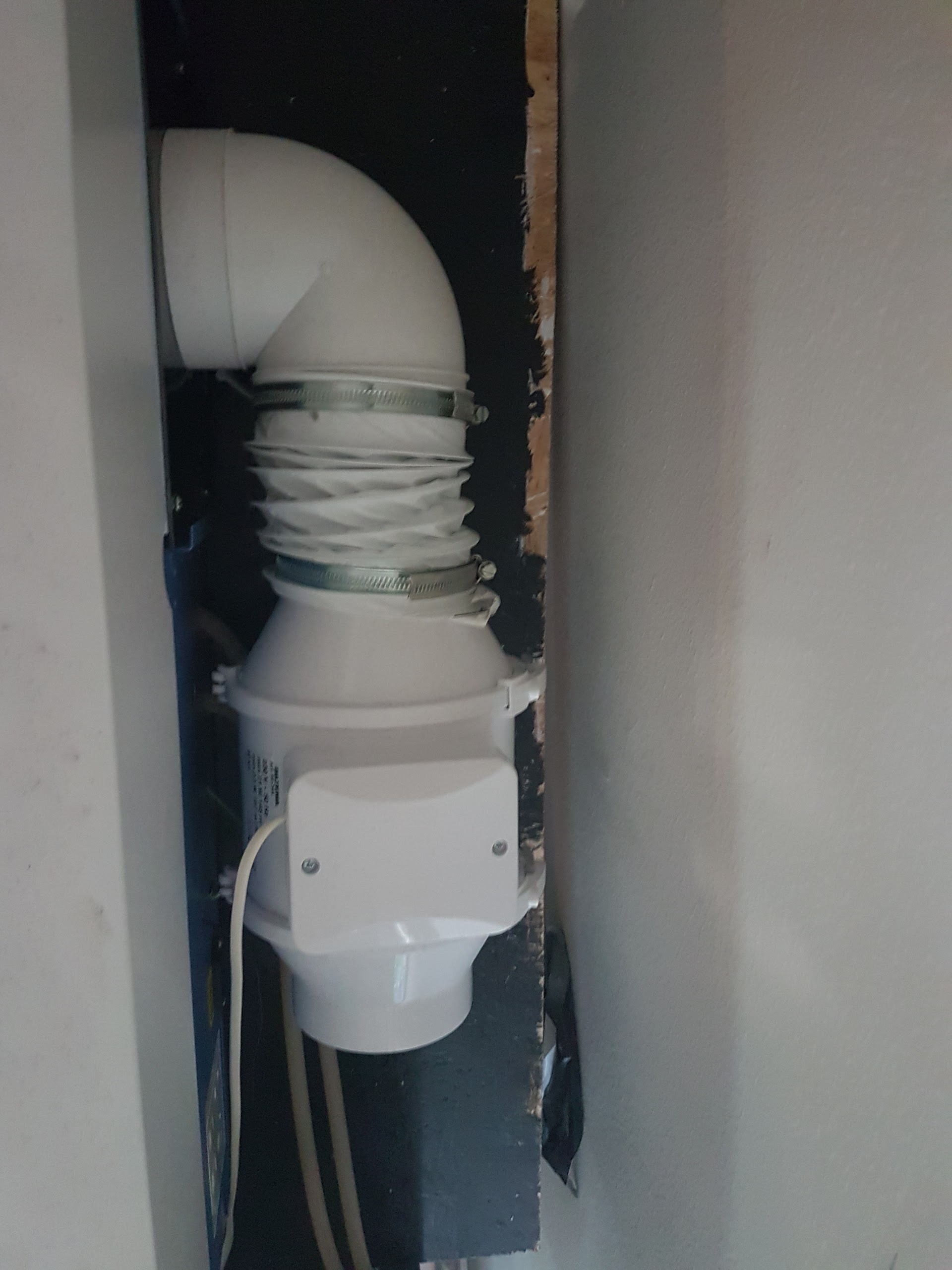

@Alex_Krause been happy with this lots of air and pretty quiet. Also large diameter. I use it with floor heating ducts and ducting from Lowes.

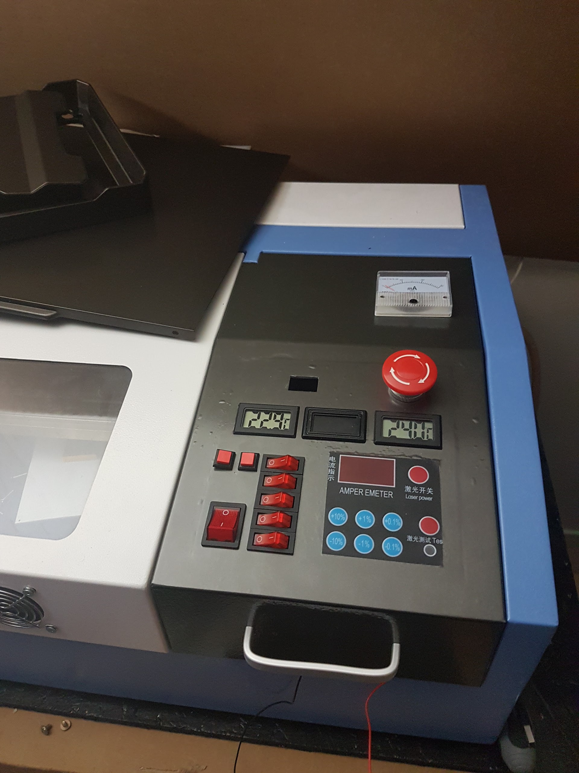

@ALFAHOBBIES Here´s my case, same as yours right?
nice control panel! i see 2 temp gauges, i assume one is the water reservoir. Where’s the other one reading from? And all those switches?(guessing laser pointer, air assist, ventilation, lights, water pump?)
@Domm434 Actually three temp displays, one reading tank temp, one reading the cooling loop temp, as i have two pumps and two loops, one going to the tube, the other trough a peltier and radiator, and the third meter reading the PSU temp. The empty hole above the meters was for a digital mA-meter, but never installed it.
The two square buttons runs my autofocus. Other switches are as you said, lights, pointer, fans, cooling loop and last one is a cool down, a relay with timer running the water for 15min after machine is turned off.
This was my prototype panel, will change it in the future as i have converted to @donkjr suggestion on a improved potentiometer (multiturn with display)

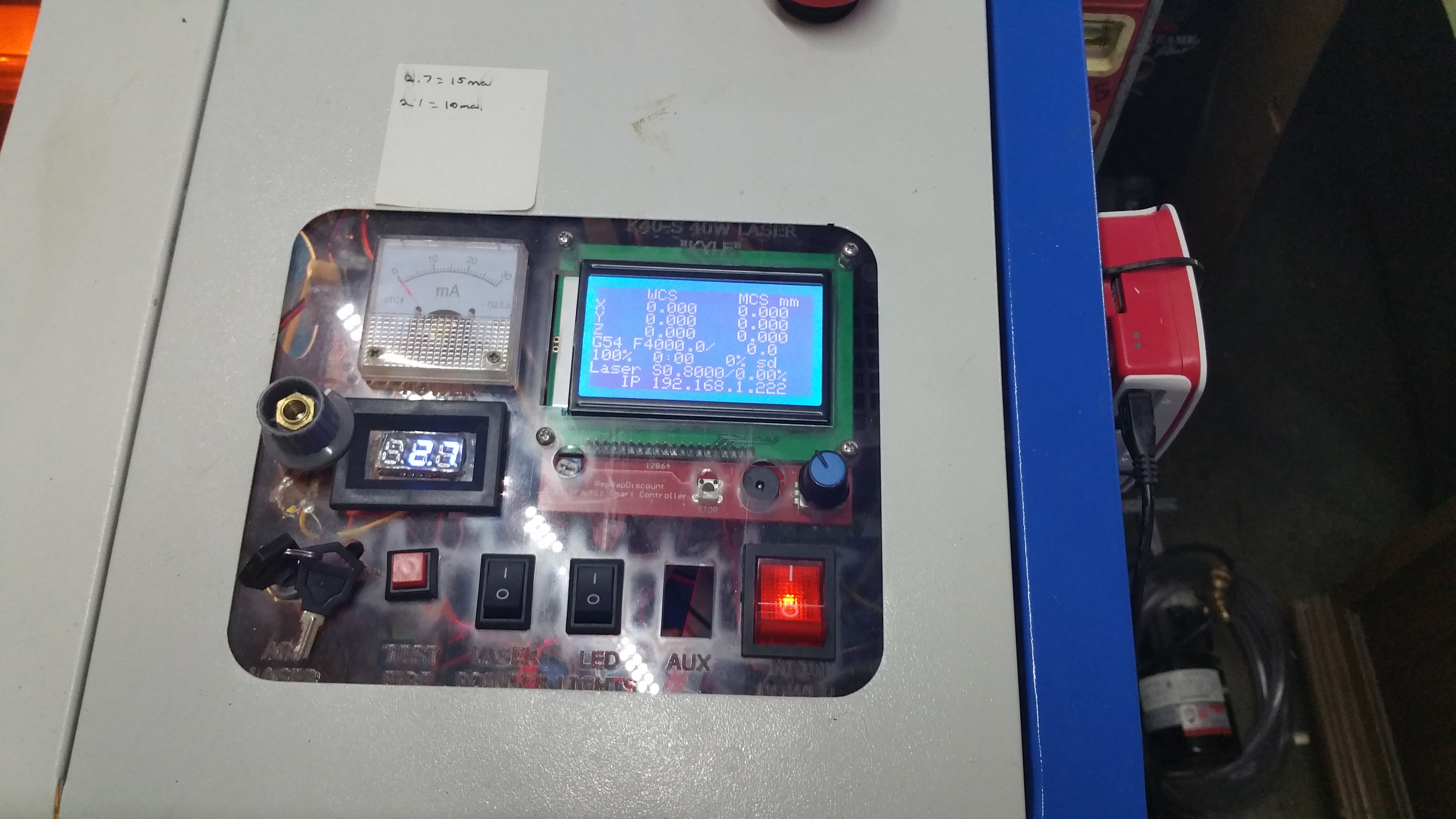

here’s my current control panel, still need to re-do it though not happy with the fit on some of the components yet. ma meter tied to pot for a 0–5v readout and temp meter not attached yet (its on the water tank itself atm) Yeas thats a RPi strapped to the side of it running lw-comm server
@Domm434 Nice one, have to remake mine too, to fit the display for the Cohesion conversion. Nice and tidy setup you got there
