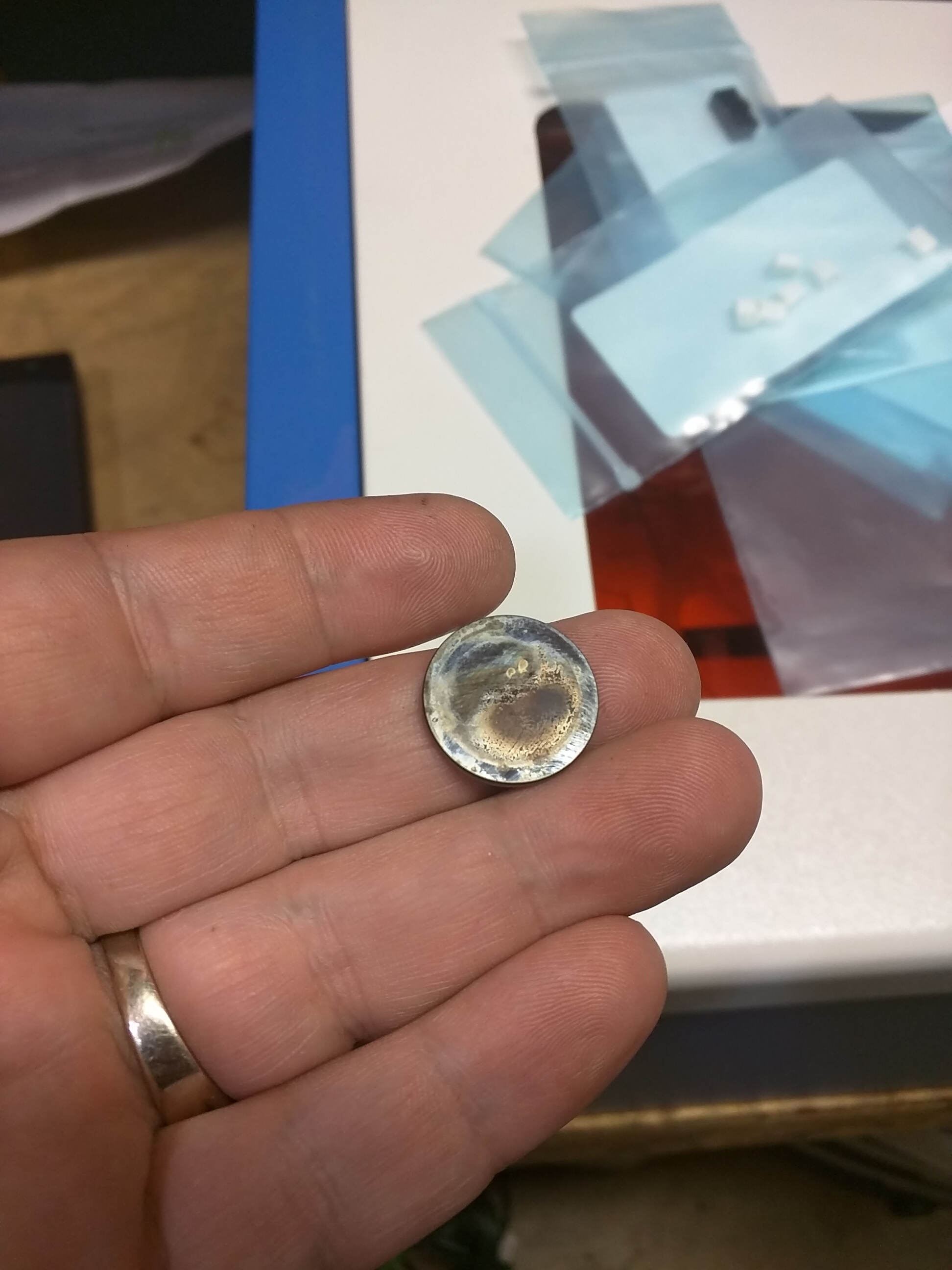

My stock mirrors were crap! Lol I finally just ordered some MO mirrors from
My stock mirrors were crap! Lol I finally just ordered some MO mirrors from ebay. Should have them next week
Thanks for that, just ordered the same after seeing your old mirror in the photo! Haven’t looked closely at mine yet but if they are okay then at least i’ll have some spares.
no prob, that’s why I posted. Check your mirrors, even if they are not as bad as mine they are still not as good as a good mirror. We want as much power as possible reaching our work piece. specially when we are already limiting our power to preserve the tube life.
Ye i’ve seen the tubes going for £140 ($212).
Keep the mirrors clean it’ll help them last longer. As a side note I’ve seen tutorials on making your own mirrors by cutting them from old hard disk drive platters. They are supposed to work/cut better than the original mirrors. Don’t know if that is a statement about the DIY mirrors or the ones that come in these imported machines.
Absolutely, this is how my mirrors came though. I’m still converting my control board etc before I start cutting
Wow, that’s shocking! My lense and mirrors had slight scratching but seem okay, but nothing like the deposit of crap burnt into yours!
One of the things that was rather surprising to me was that the mirrors that came with my machine are not glass coated. They are actually metal discs. I don’t know what kind, but they are metal none the less. I keep hearing people say theirs were glass coated and they’re crap. But when I took all of mine out for cleaning, that’s when I noticed they were metal. I guess for $366, I lucked out.
Mirrors arrived on Saturday amazing how reflective they are. They are thicker but they still fit. Molybdenum is heavy!
