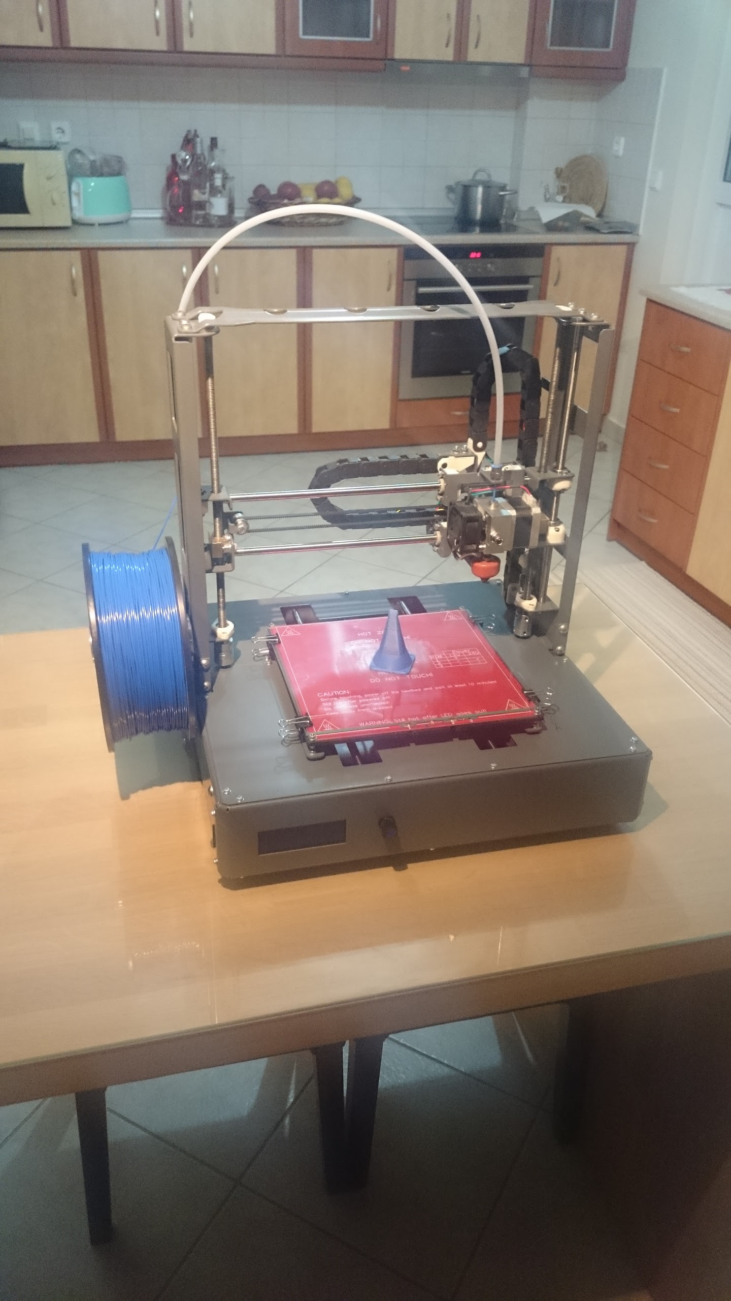

My third 3d printer STAPS 100A
Love the sheet metal work. Have you noticed any wobble towards the upper limits of the z axis?
Thank you my friend, regarding the wobble issue I was aware from my previous printer and in this version the bronze nuts have free play to the X direction and I have solve the problem.
