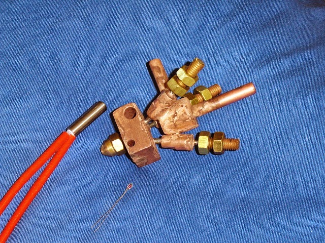

My Tri-colour all metal hotend with a single nozzle that I use in a
My Tri-colour all metal hotend with a single nozzle that I use in a delta printer.
More photos at http://www.deltaprinter.co.za/tri-colour/index.html
With the latest release of Repetier-Host V1.0.3 it is easier to work with different colours in a print.
+Peter van der Walt 2 mm ID 304 stainless tubes from Aliexpress - I had to buy a kilogram I could not find a ZA supplier.

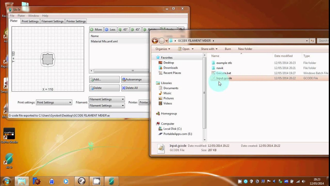

Do you colour mix too? I have created a Gcode colour mixing script for these type of nozzles should your firmware support simultaneous multiple extruders.
Thank you Steve. I have seen your work some time ago but patiently waiting for Repetier to publish his firmware for multiple extruders running simultaneously ( https://github.com/repetier/Repetier-Firmware/issues/286 ) before I go the mixing route.
