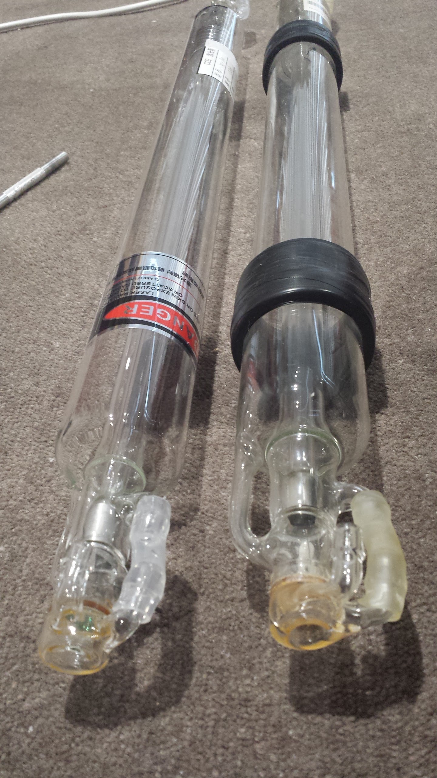

My tube arrived from China after 5 days! It's a tube from reci-laser,
My tube arrived from China after 5 days! It’s a tube from reci-laser, Shenghui factory shipped AUD $285. Nicely packed with care and not broken, pffff. Installed it and now have to wait for the silicone to set. Not taking any shortcuts here😰

@Yuusuf_Sallahuddin_Y i had a night for the silicone to set so after work I give it a go.:sweat_smile:
@donkjr I have a RECI tube (100W) and it works very well. My tube will actually produce more than 100W, but 100W is the nominal value at 26mA as measured. They also included a power rating chart per mA on the tube. Which my testing has shown to be accurate.
@Maker_Cut my new laser tube works really great. Laser cutting is working already at 3mA before i needed 8mA for leather. Will post my laser cut wallet results tomorrow.
@donkjr so far the results are really promising with the new tube. Will post my results soon.
