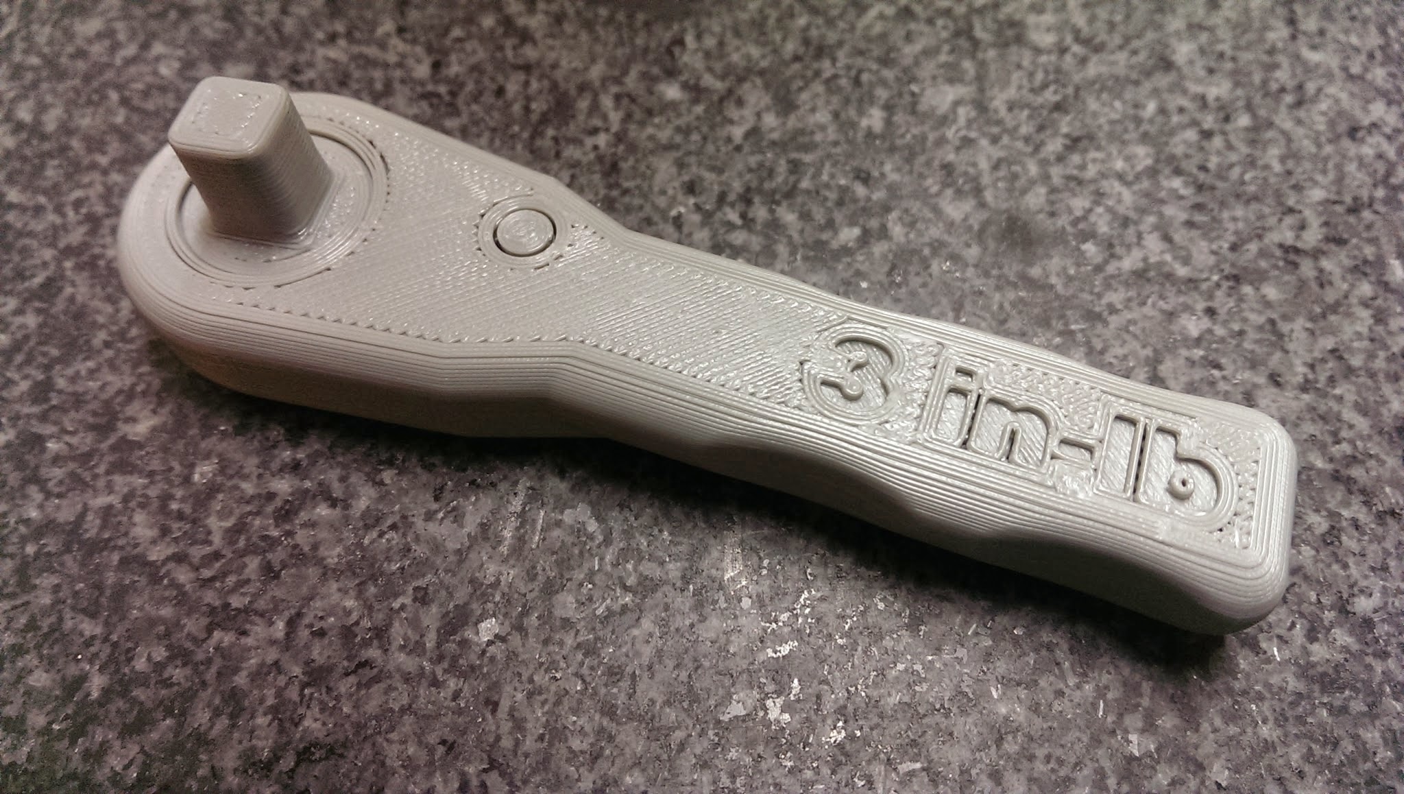

My turn at NASA's tool.  Turned out quite well.
My turn at NASA’s tool. Turned out quite well. I hair under extruded, but looks nice. Printed in Filaments.ca ABS
does it turn. I’ve broken 3 trying to get it loose and did one in parts and assembled it that does
Yes it turns, and locks properly. Would only tighten a bolt clockwise.
What where your print parameters.
Extruder 230
Bed 115
Extrusion Width.48mm
.3 high
50% infill
3 perimeters
layers for top and bottom surfaces
****But here is the key I believe the Extrusion factor 0.91.
Printed on a Mendel90 with 0.4mm Nozzle J-Head
It only took a little nip in a vise to set the works free.
We’ve made two now that don’t turn. We have a third try going in a 5th Gen Replicator as I type this. This time we went for 100 micron layer height to reduce extrusion width.
Try reducing your extrusion factor. Also printed it while enclosed in a box.
