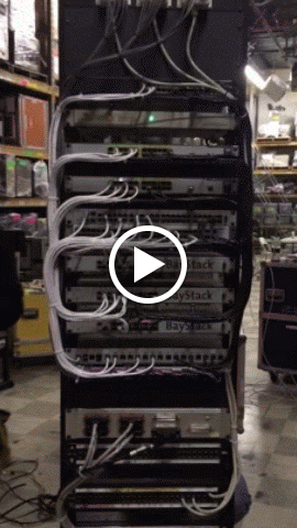

My version of Mark’s holiday lights…
never quite got the density right…but I’m from the school of coding where I just start changing numbers in the sketch to see what it do & if I like it or not…
Wait, is this legit? You’ve installed LED strips inside the back panels of a bunch of servers?
I have indeed…gonna be a prop on a TV show…they don’t like fans
AND they’re shooting in a fer-reals data center which means heat is an issue as well…plus, the network switches don’t really light up unless you’re passing network traffic…so a strip or so and a wee proc & off we go!
Bravo! Can we submit code to appear in every new episode? Haha
Are you guys hiring BTW?
heh…if you’re in NY & in IATSE, I could use ya! (but I DO need some code help…I’m clueless…for instance, I wanted to make the pattern more dense-more lights on/flickering at once, with that activity light feel, and this was as close as I got…thanks to Mark’s great commenting in the sketch…) the 2nd server is actually using a box I had made & coded with some preset patterns in it & controls…doesn’t use FastLED though…all c++ sketching which makes me more confused…
Well, I’m on the west coast…if figured TV “he’s in LA”. I specialize in metal work/welding.
If you share the code here, I’m sure plenty of people will chime in, or if you want to keep it private you can email it to me. I’m no professional programmer, but I make up for it in patience and persistence.
its just Mark’s holiday twinkle code & I changed the numbers I saw to try and make more ‘activity light-ish’ I cranked up the density trying to get more pixels on at once…it sorta worked, but I wanted more…

“Routers don’t look like routers on TV, you gotta use a ColecoVision…”
Here’s how I added more density: see the part of the code where it says this?
// Now consider adding a new random twinkle
if( random8() < DENSITY ) {
int pos = random16(NUM_LEDS);
if( !leds[pos]) {
leds[pos] = ColorFromPalette( gPalette, random8(), STARTING_BRIGHTNESS, NOBLEND);
setPixelDirection(pos, GETTING_BRIGHTER);
Just wrap that with a little for loop that does that two or three times:
for( int repeat=0; repeat<3; repeat++) {
if( !leds[pos]) {
The other thing you can do is put in a line that says “if the first random pixel position chosen is already lit, try picking another, once”:
if( leds[pos]) pos = random16(NUM_LEDS); // try again
if( !leds[pos]) {
And did I mention that this looks super cool!!? Can you share what show this is for? Looks great!
thanks for the suggestion! I’ll give that a shop later today…was making the density variable 5000000 fruitless? where should that live?
its for a new show called ‘Odyssey’ pretty sure it’s NBC…things are crazy stooped busy in NY right now with a bunch of new shows…to the point where I can’t keep it all straight…holiday hiatus can’t come fast enough!
Yah, DENSITY maxes out at 255. More is the same as that.
But if you add the repeat loop and that line about “try again if that one’s lit” you’ll get much more light.
gotcha…and for my edumakation, what exactly do ‘density’ mean in this instance? 255, to me signifies that it’s based on a color value…or is it something else? (part of me would think it would relate to number of pixels in the strip, but as I’m learning, and having trouble with, things are different meanings in code-world)
“255” is the highest value that you can have in any one-byte (8-bit) variable, so it shows up all over the place.
In this case, when I wrote the code, I was coding on a smallish strip of maybe 30 pixels, and they seemed to be “on too much of the time” for me, subjectively. So instead of trying to re-light a new pixel each time through the loop, I put this around the re-light code:
if( random8() < DENSITY) {
… light a new pixel …
random8() returns a single byte, and 8-bit value between 0 and 255. By putting this random condition around the ‘light a new pixel’ code, it would only execute it some of the time, and how often was controlled by DENSITY. E.g., if DENSITY was 50, then a new light would be attempted only when the random number [0…255] was less than 50. That works out to 50/256ths of the time, which is 19.53125%; we’ll call it about 20%. So 20% of the time it would try to light a new pixel, and 80% of the time it would skip that: presto, lower ‘density’ of lights. So it’s actually a density- reduction system: it’s skipping light some of the time, not adding more light, if you see what I mean.
But you can also see how if you set DENSITY to anything 256 or higher, the “if” statement will just always be true:
If DENSITY is 10000, that’ll always be greater than the one-byte random number returned by random8().
And this is why if you want to light more lights, you just have to execute that part of the code multiple times: try to light two lights each time, or three, or five – and you’ll actually add more light.
ahhh…English! I love it! many thinks…now off to the tinker bench!
