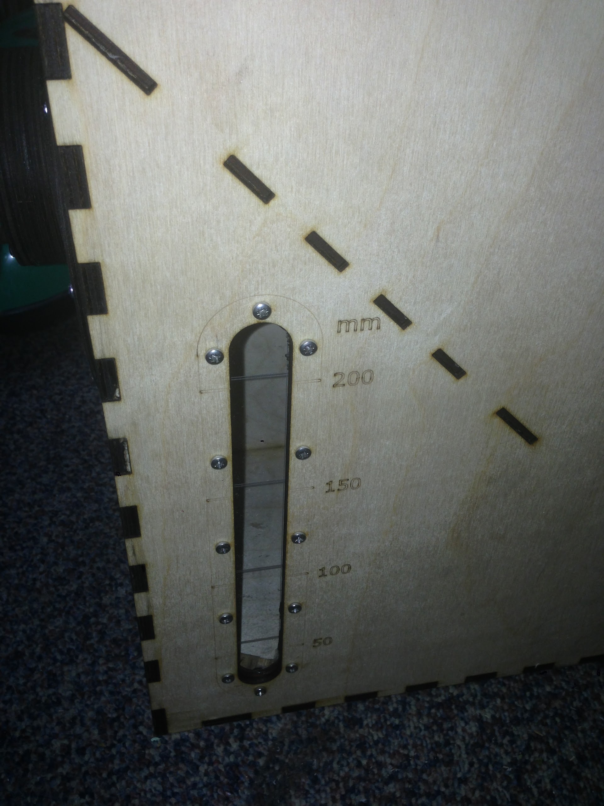

A vacuum air filter for my Shapeoko 2 and Laser cutter
@Grant_Macaulay How does this work? Any Construction details available? I build a dust collector for my CNC router, but still dust gets in the air, so if this scrubs air around it I am interested in building similar.
I have been mulling over the design for weeks. Final drew them up yesterday and started laser cutting yesterday!!
I am seriously thinking of putting this all on Instructables. Maybe even a kickstarter making the plans available to all.
Just plugged it in and switched on the vacuum. It works so much better then I had expected :))
I bought an out of date car air filter from the local shop and put all the dimensions around that. Better go buy a few more. Already thinking of adding a large particle filter I front of the car filter and using it on my laser cutter project.
I also removed the dust bag and all the filters in the vacuum.
I have got to put it on the CNC to test how well it works. I need to build a suitable mount for the Makita to take this 57mm tubing.

I have added two more stages of filtering add mounts for my CNC and tested it in anger on my first metal cut. Really happy with the out come.
