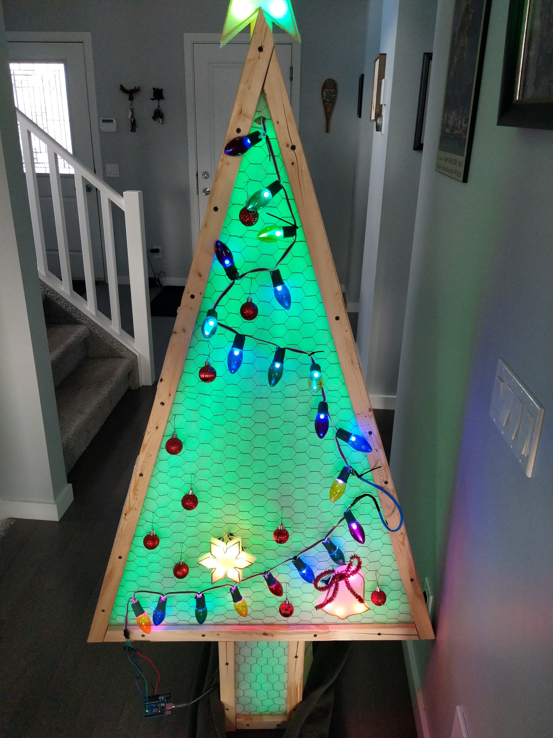

My wife and are working on a Christmas tree project,
My wife and are working on a Christmas tree project, I’m looking for some guidance. I’m looking to add pir activated face that sings some prerecorded Christmas songs and phrases from mp3. I have hacked together some code. All parts of the code work seperatly, however I’m having no luck using a Dfplayer mini with fastled. I’ve searched this forum and at least one other person has had the same issue with dfplayer+fastled. I’m using a seperate 5v 2amp PC power supply for the LEDs. My platform is the uno. If the platform is an issue, i also have a metro, esp3866, esp32, yun and pi zero w. I prefer to use the uno and port the code to other platforms once im happy. My code is at https://pastebin.com/BwJzMmpv. I’m using windows 10, latest Arduino IDE and fastled lib.
