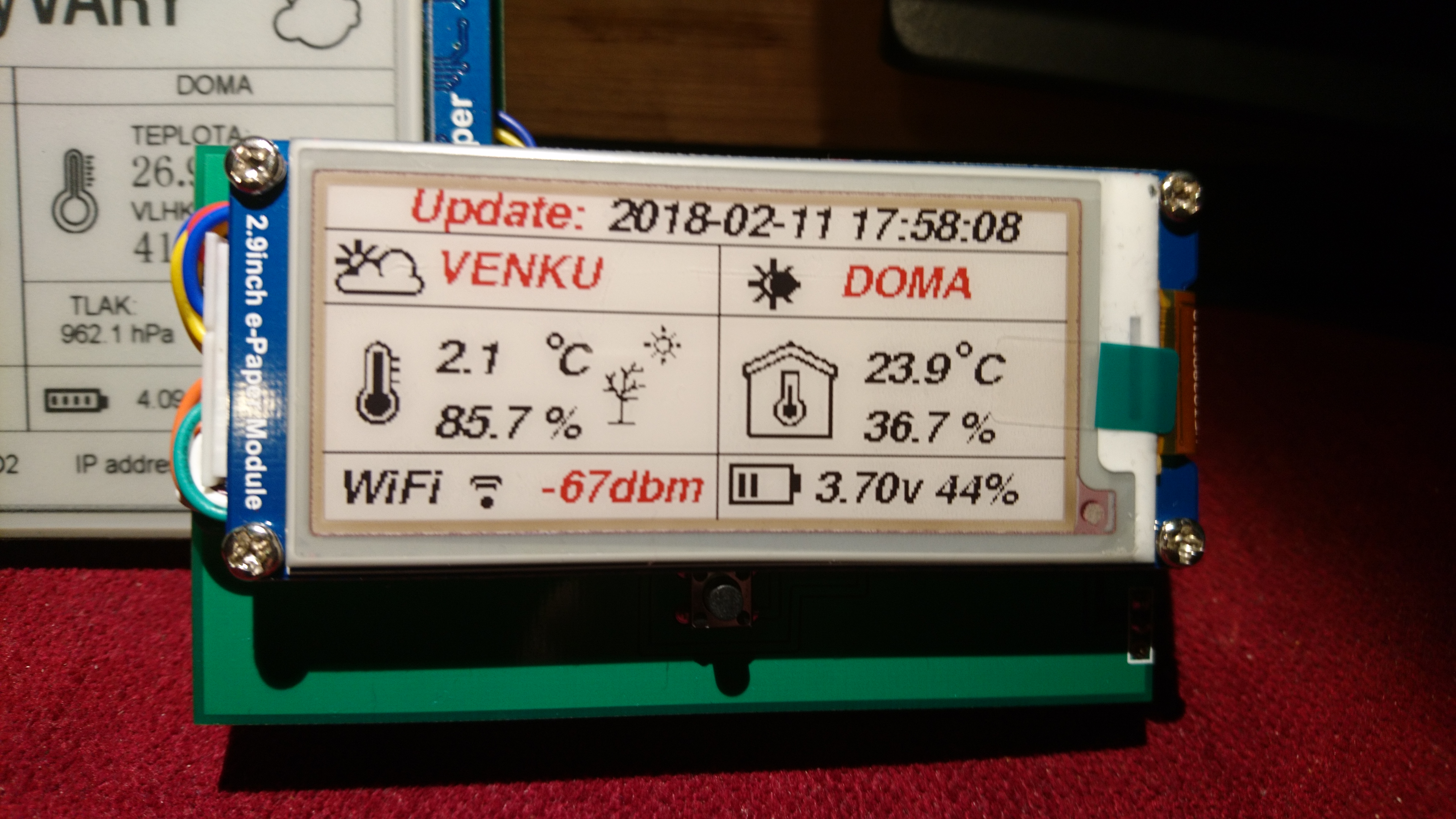

My Wifi ESP Weather Station with ePaper 2.9 runs
on one charge for a month!

@Markus_Illenseer just Google for esp8266 and deep sleep, it’s built-in. Just tell how many seconds to sleep and it returns to your setup() function. And the e-paper costs no current between updates.
@Thomas_Runge @Markus_Illenseer Also, remember to connect D0 to reset, otherwise the ESP will sleep forever …
