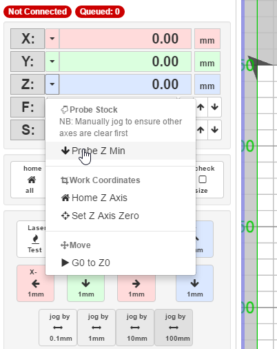

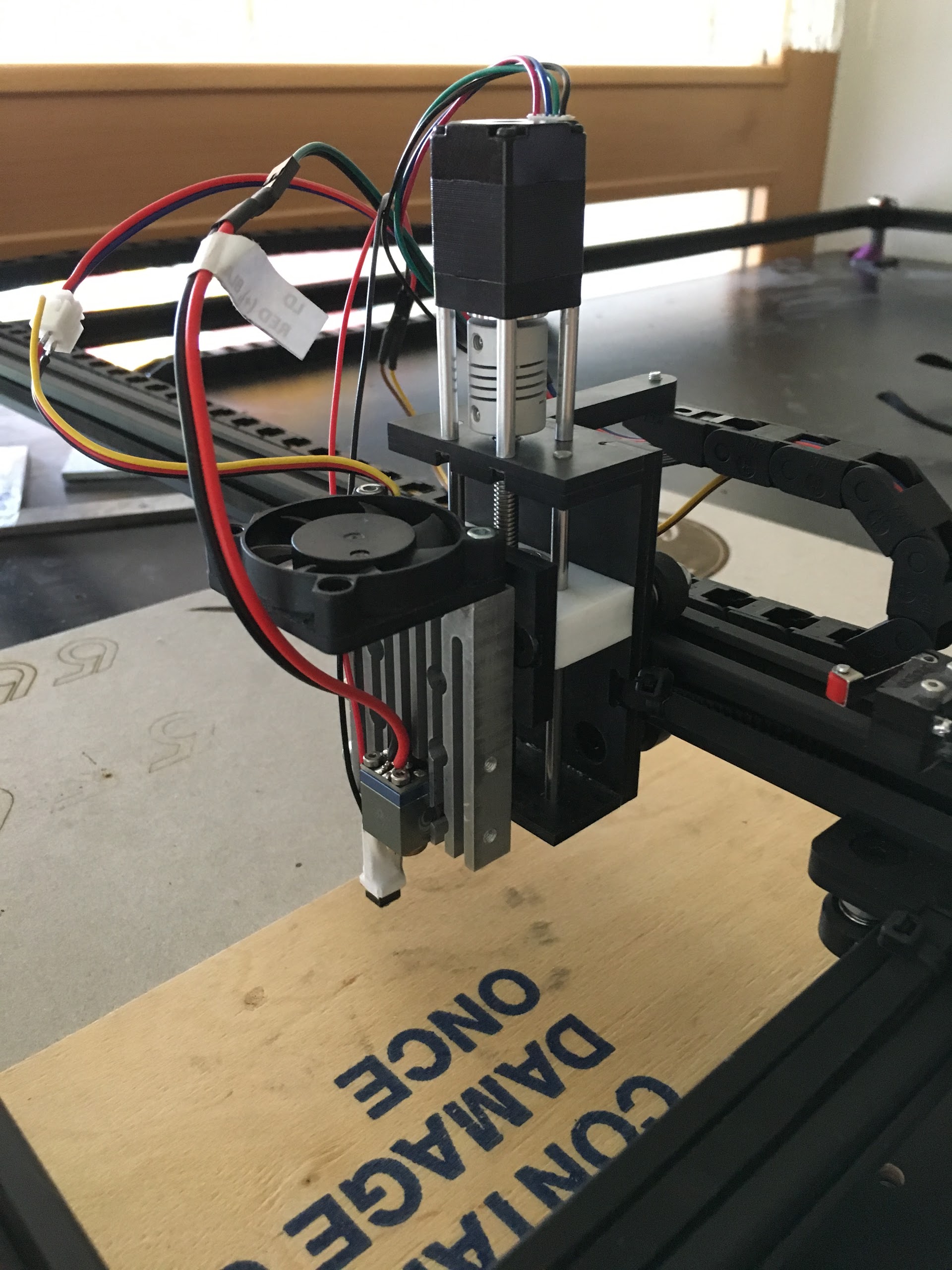

My z-axis is finished and now I have to set the z-probe macro (G38.2 Z-30 F1) (G92 Z10) (Z0)
but it wont work. After (G92 Z10) I got an ALARM: undefined! My focus is 10mm about the micro switch.

I think I found the Problem. I dont have a Limit switch in my Z-axis and if I start probing not at the upper position it fails because of not enough travel way is left!
I have to install a Limit switch in top of my z-axis to home before probing.
Or is there another way? Now I have to jog manually to the upper position until soft Limit is reached before probing!

Is there a way to set the z-axis to machine z zero, not the work position?
Mabe this can help you to configure an connect the end stop swiches.
@Domm434 right, i forgot the -
