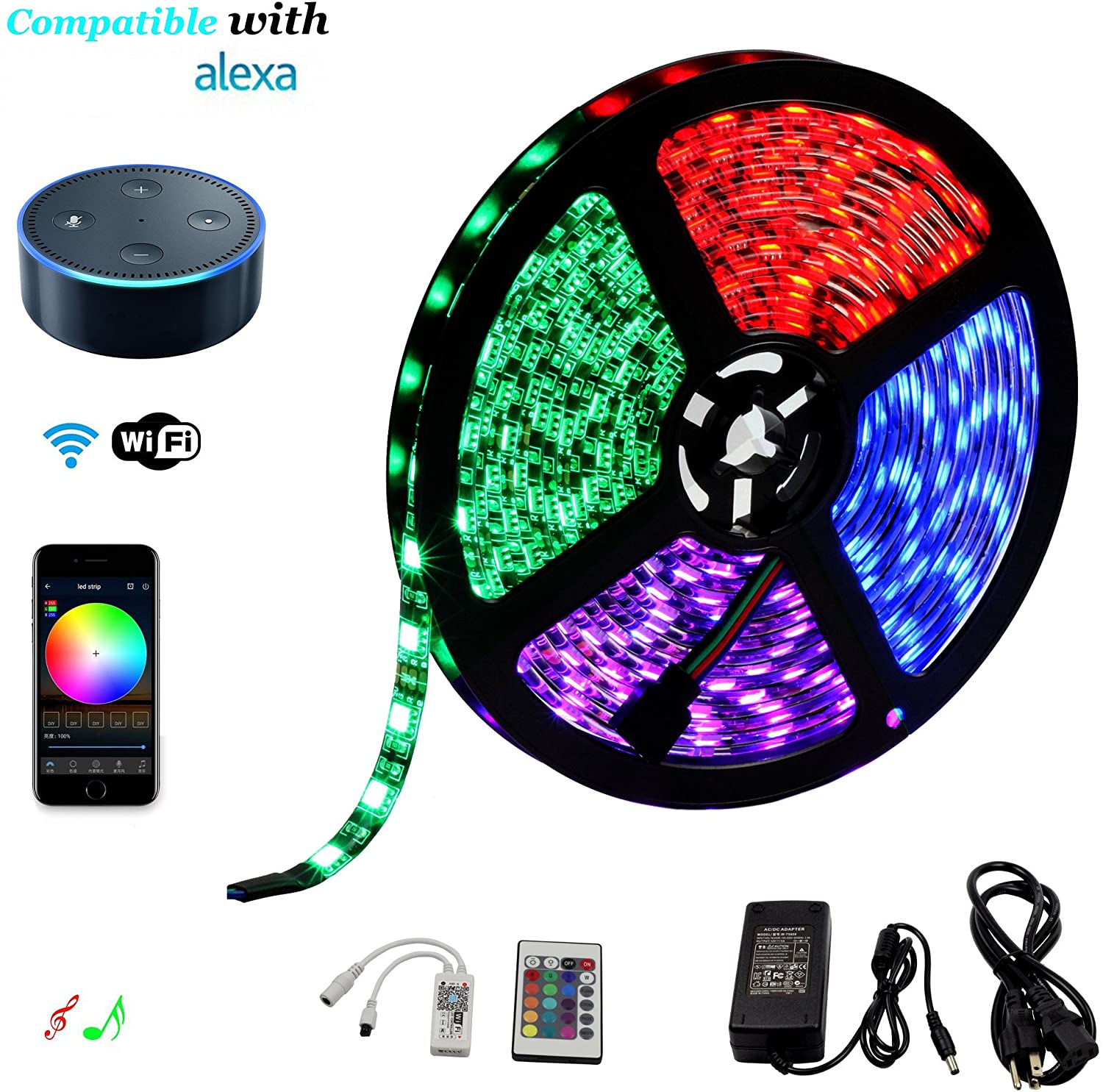

Thanks Jason, These are the LEDs I am using and I am ditching the little WiFi controller that comes with it. I’m also having some “fun” trying to step the voltage down from 12v for the ESP8266 board. I may just have to use my Arduino since I can run it off of 12v input and split it off to the LEDs before powering the board, but no WiFi which is no biggie this time around as I just want this to be a power it and forget it type of device and don’t care just yet about manually selecting a color, etc. via WiFi.
hey man, looks like those are non-addressable LEDs, so you’ll only be able to change the colour of the whole strip at once. I’ve used an arilux lc-01 wifi controller in the past, and found it worked great. it takes care of power and colour, so all you’ll have to do is provide dc power and connect it to your wifi. at that length (450 in series) you’ll need to address resistive losses due to the thin traces. multiple connection points (ie run cables for r,g,b,+ from the controller to multiple points along the strip with sufficiently thick wires) or multiple controllers.
@Alexander_Forster Thanks for the input. I need to stick with the equipment i have available for now since money is tight and the timeline is closing fast. I have this setup from the link above, and I do realize they are non-addressable. That was kinda part of my original question if these RGB strips are compatible with FastLED or should I just use something else.

@Gerard_Pesce To answer your question a bit more, if you have these LEDs lighting up, then yes they will also work with FastLED and technically you could even use any example sketch. The NUM_LEDS would just be 1 though, as you basically have a really long single pixel. For many sketches changing NUM_LEDS to 1 might not look very interesting, but it should work. In an example anywhere there’s a FastLED.show() that would be replaced with sending the individually r,g,b values to the output pins.
