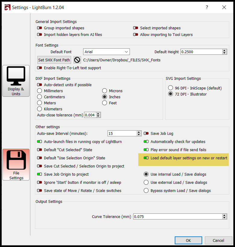

That’s most likely because you have the setting highlighted in yellow turned on. If you do, Lightburn defaults the mode to be what it was the last time.
Interestingly I do not have that setting turned on. hmm.
I have it on all of the time, because I tend to use black for engrave and red for cut.
The “hmm” was for the fact that it wasn’t why it came in defaulted to Fill if pasted directly into LightBurn. When I converted the outline to a path in Inkscape and then imported the Inkscape file(SVG) it was layer 1(blk)=Line and layer 2(blu)=Fill which is what people would want.
