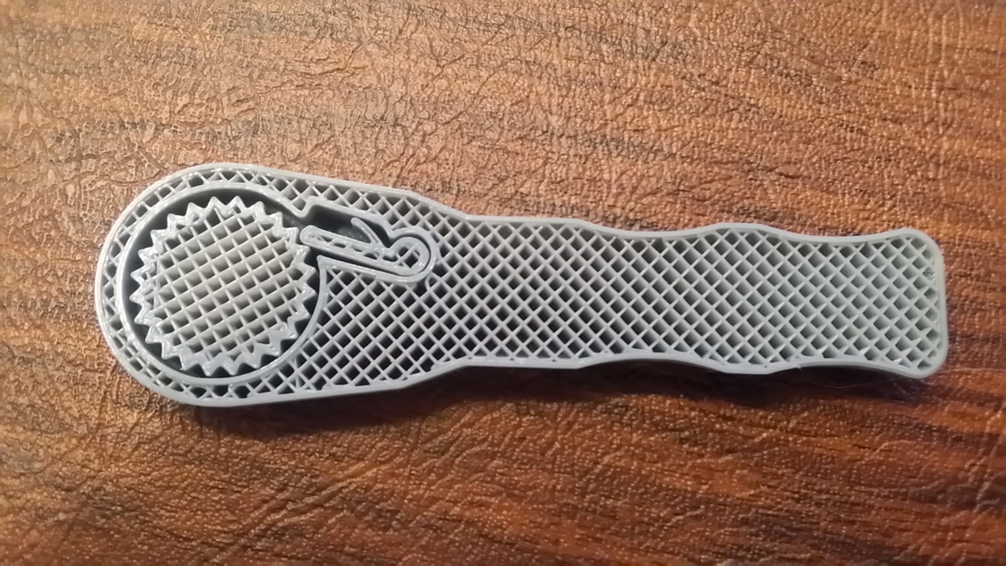

NASA Wrench cross section

Not failed I stopped it halfway through… I printed 3 of them
@Jerry_LePore Yes, of course you did.
What’s your print settings? Mine wouldn’t turn.
Makerbot Replicator 2
Sliced/ S3D
no raft- no support
20% infill- 2 shells-.25 mm Layer Hgt

i see why alot of them are failing for people… no substance internally

I printed one but it wouldn’t turn. I’m going to reduce my temperature and try again.
