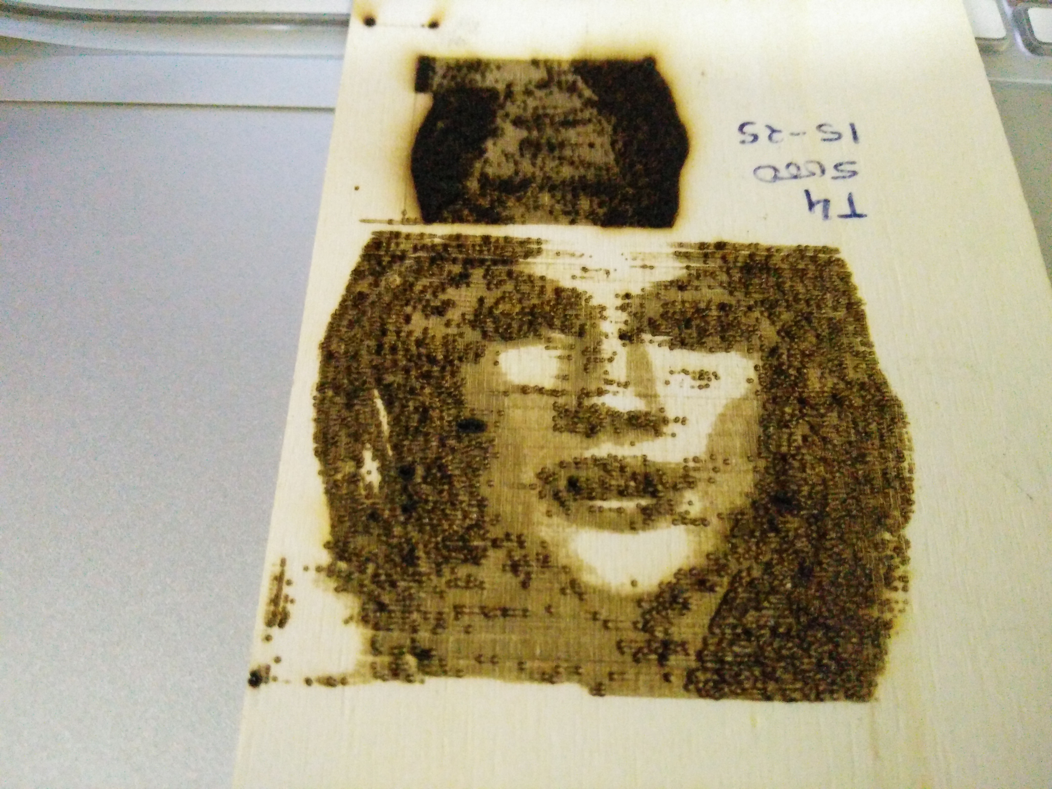

@NathanielStenzel Here are the results.
And these are my settings:
Picture: 1 w/o Speed Override
Power: 10-30
Pixel Ratio: 0.2mm
Feed: 3000
Rapid Feed: 5000
Picture: 1 WITH Speed Override
Power: 10-20
Pixel Ratio: 0.2mm
Feed: 3000
Rapid Feed: 5000
Black is much better, but still the deep black dots, because laser stops for bit before it change the intensity or something like that. but its getting better thats for sure.
