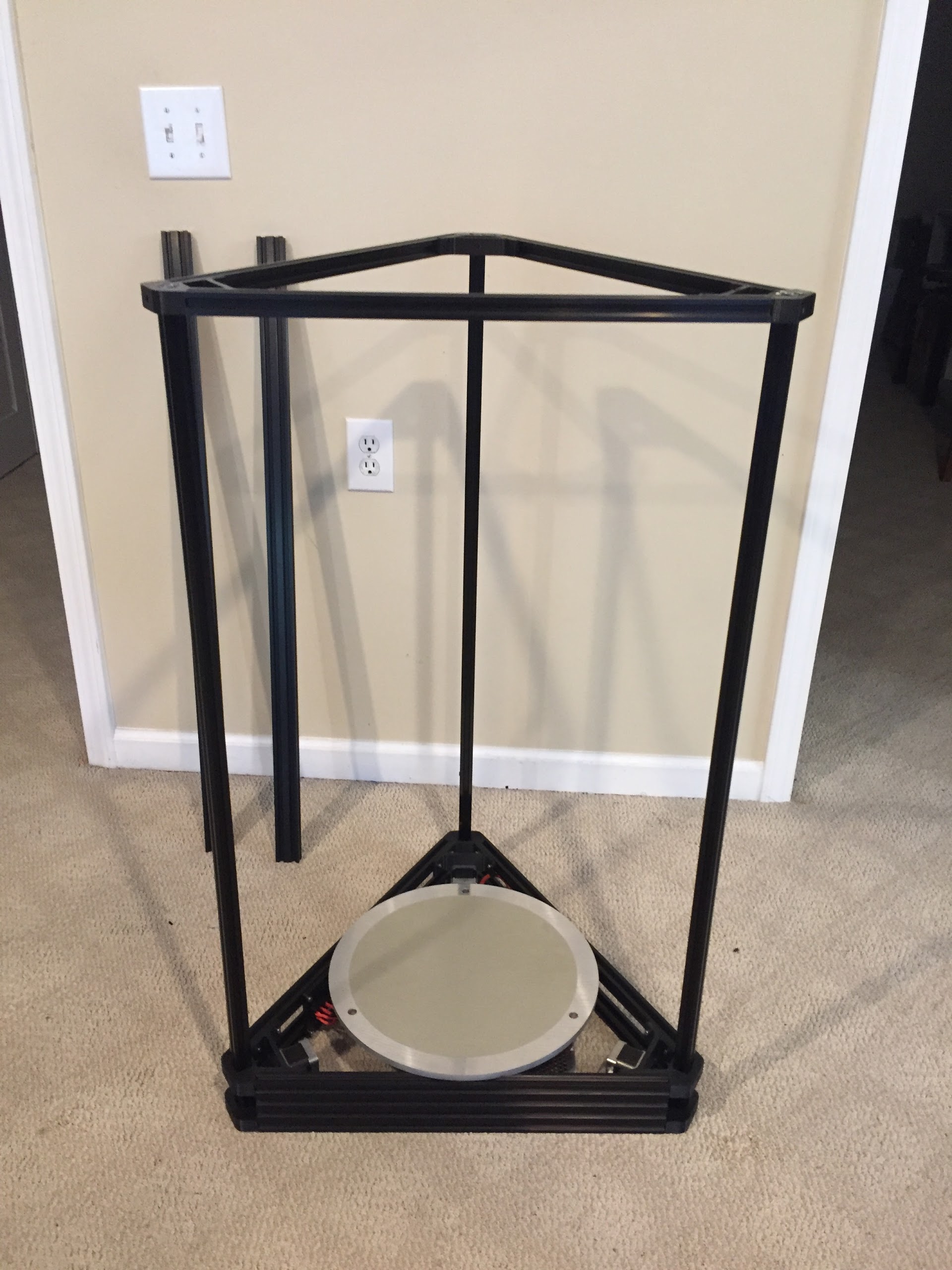

Nearing completion on this build! Need some input as to where I should mount
Nearing completion on this build! Need some input as to where I should mount the spoils/ extruders. My initial thought was on the two support braces that you can see in the background. Those will reside one on each of the back two sides. I wanted to then put the extruders and spool holders on the back. The top however is quite open so it got me thinking. What do you all think?

@Alex_Skoruppa top it is. And I didn’t think about the heat time when I ordered the plate (which was a huge mistake) but it’s Mic6 and 365mm diameter 9.5mm thick and I paid under $40 USD shipped. It was just too good of a deal to pass up. If I hate waiting (knowing me I probably will) then I’ll go for 6 millimeters

@Dan_Ghiciulescu yeah it’s kinda large. And sure! I’m just bolting the last of those top pieces in and then I’ll post one. I’ll do a before and after the braces. These are i2020 profile less the front which is a 8020 and the braces you can see in the back which are 2040.
