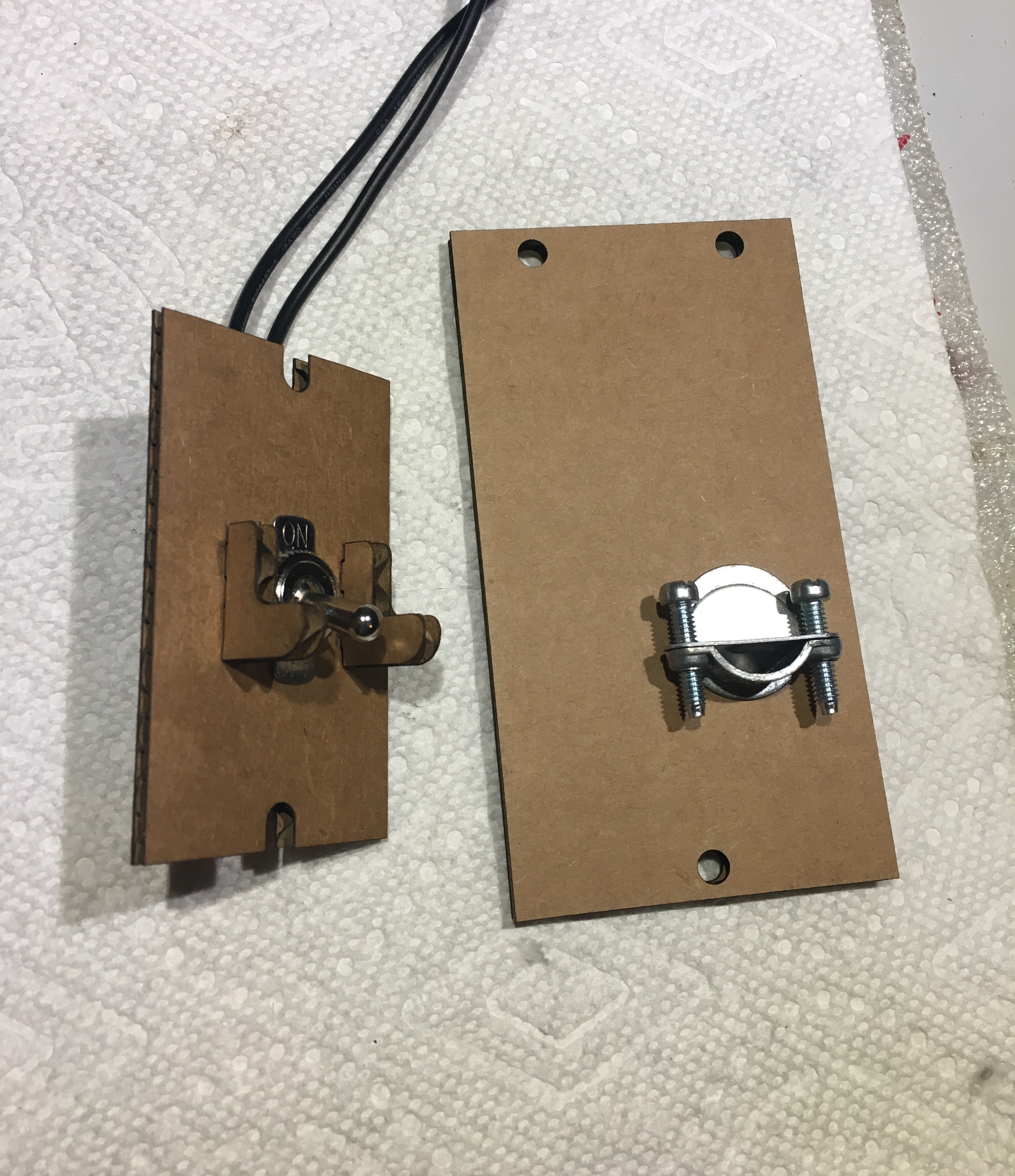

I am going to laser cut the switch compartment panels from 1/8" ply. Cut cardboard mock ups of the panels to make sure everything was correct.

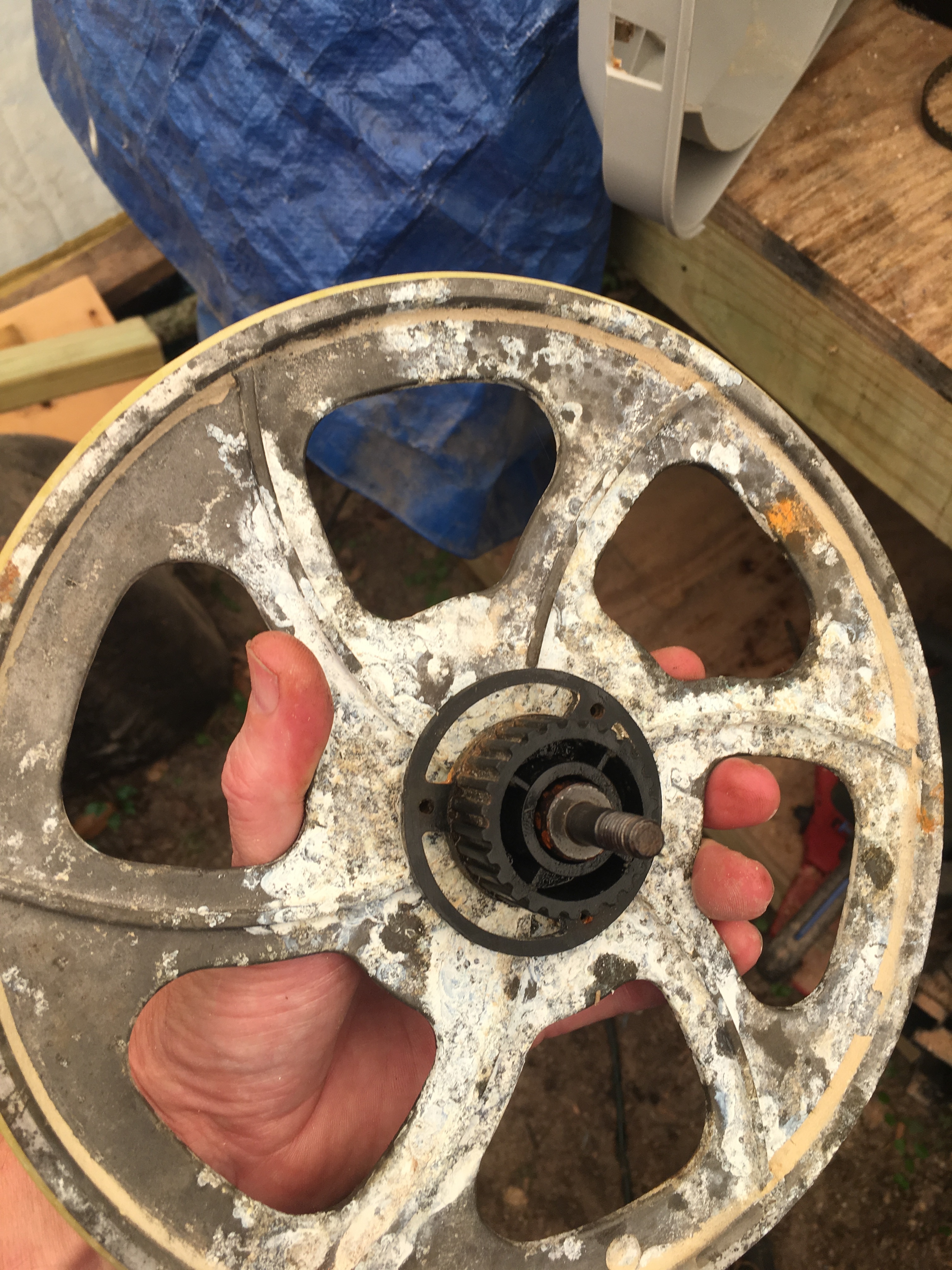

Currently tearing it down and cleaning up corroded parts. The lower wheel wasn’t turning freely so I removed it and oiled the bearing. Spinning smoothly now. Might have to replace the bearing at some point.
This is the back of that wheel. This thing definitely has gotten wet at some point. Not sure why the aluminum has gotten so corroded. Probable chemically induced by the associated steel rust, but it would require an added component to facilitate the reaction…hmmm.

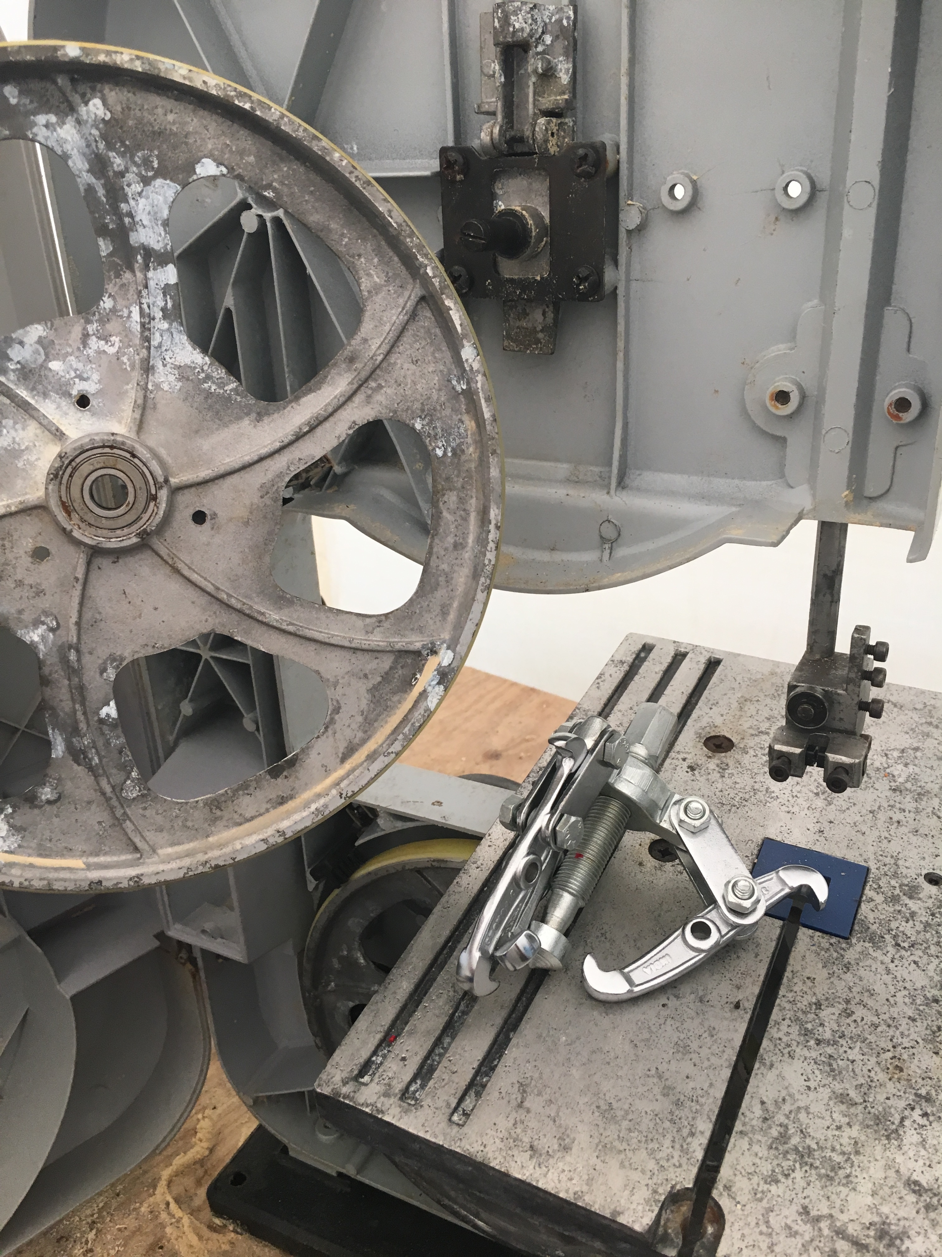

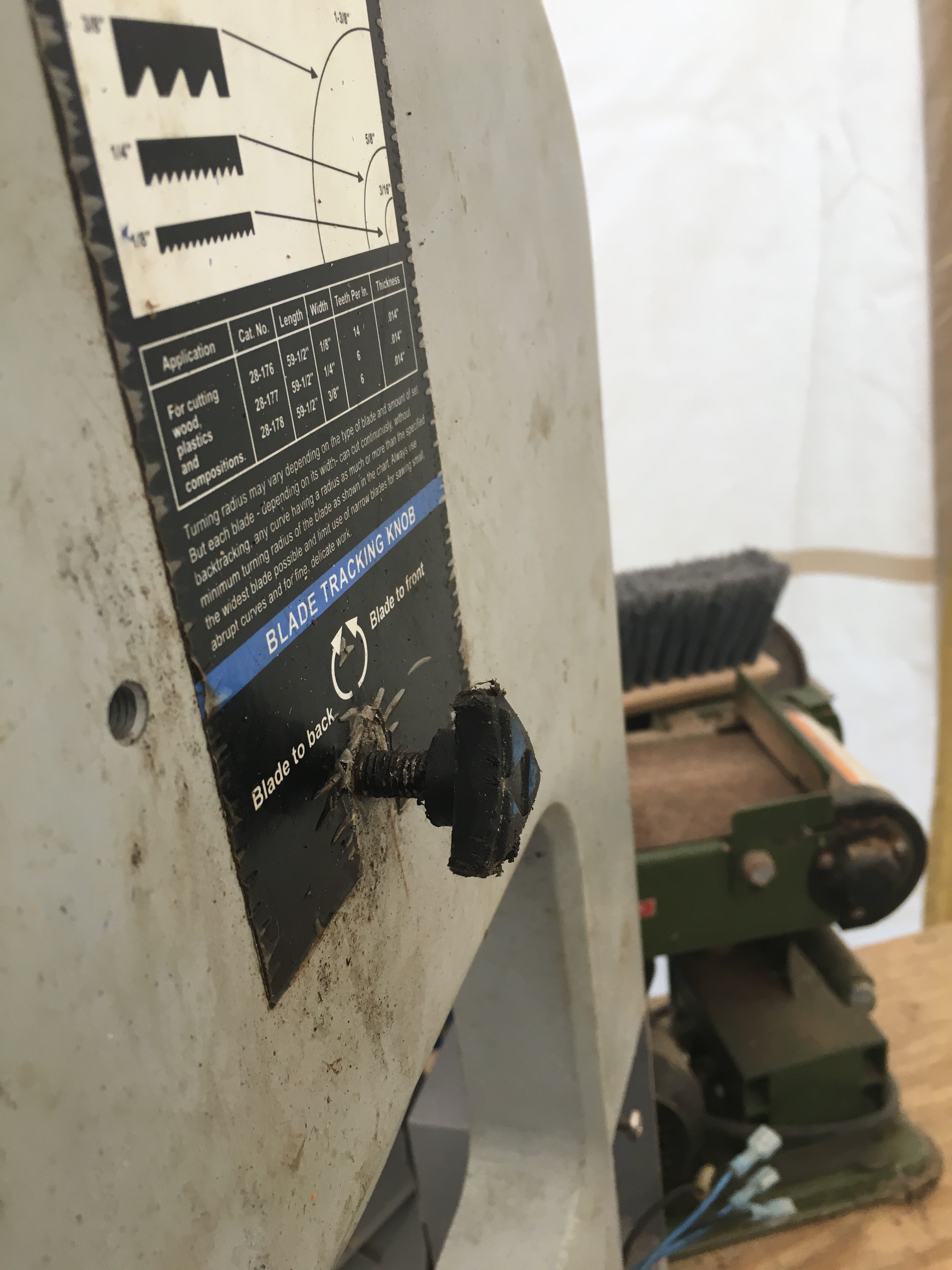

Hmmm Houston we have a problem. Trying to remove the blade tracking adjustment screw knob on the back and it’s corroded tight. Applied some penetrating oil and been tapping with a hammer but it’s not budging. Need to get to the other side of the screw. Going to require me to pull the wheel and bearing from the shaft. Now have to find my gear puller.
Well that came off easy enough.

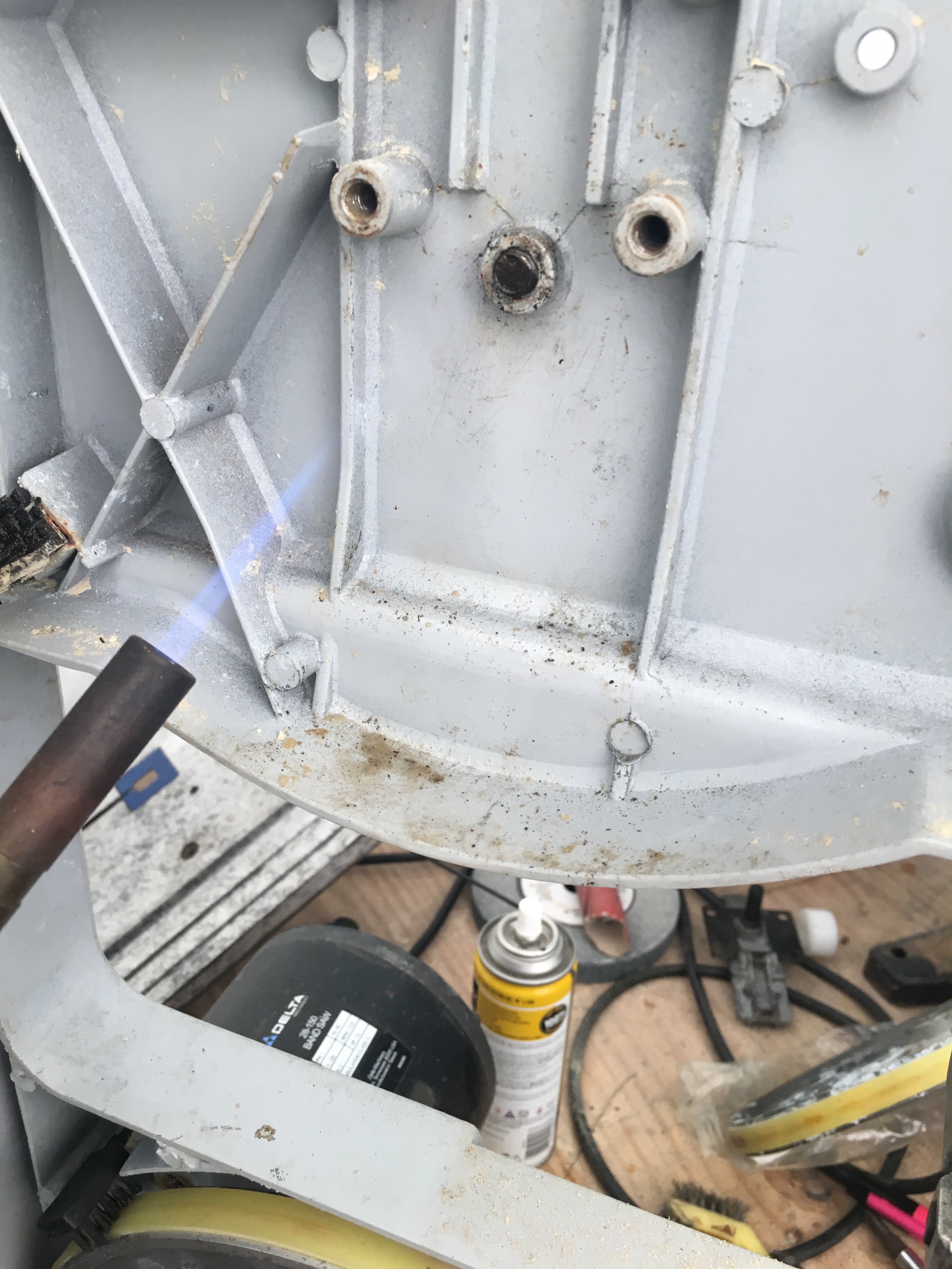

Penetrating oil and hammer tapping from the back didn’t help. Time to bring the heat.

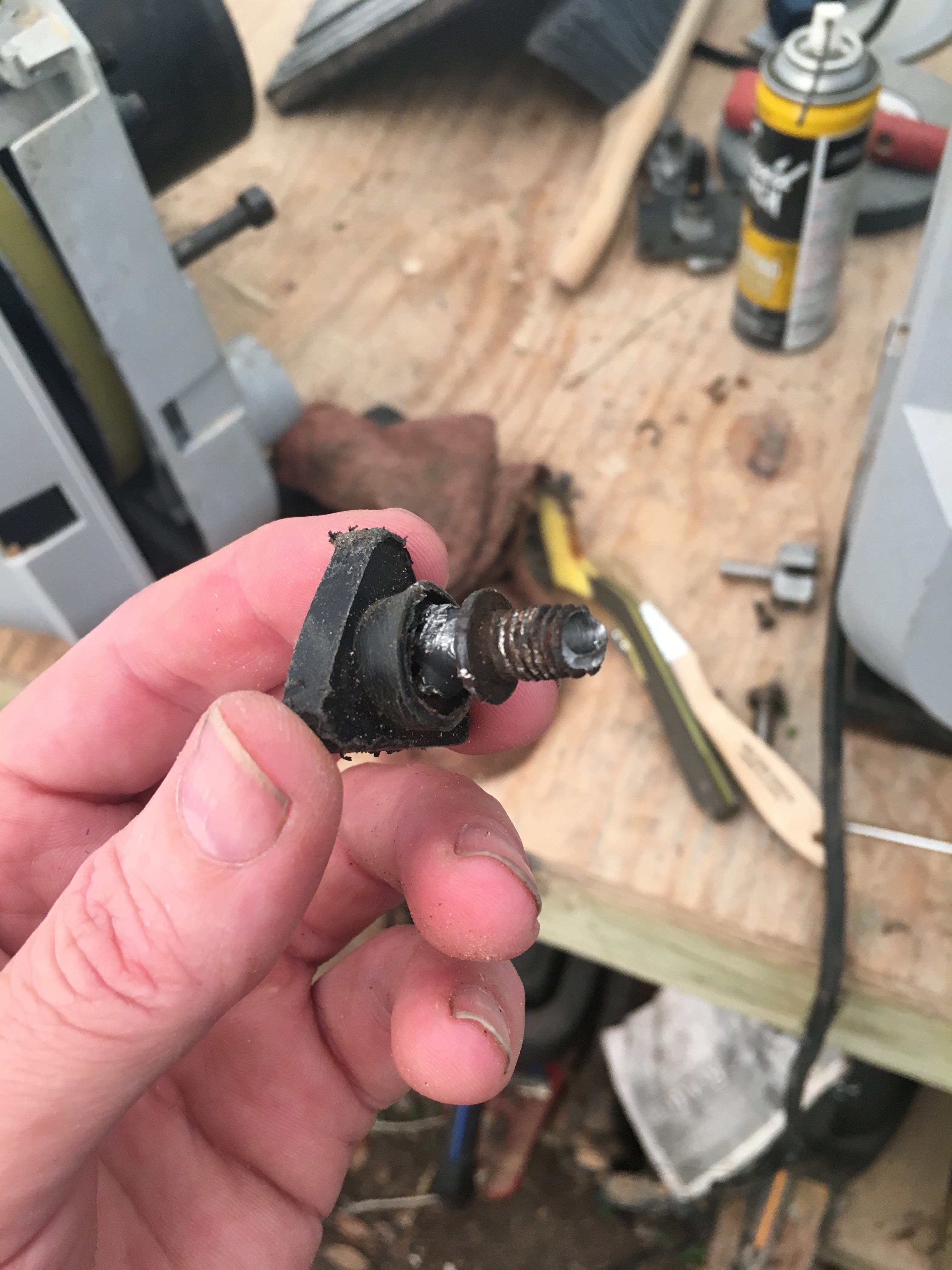

Well that didn’t work. Guess I’m going to have to drill it out from the end. Hopefully as I drill to bigger diameters the threads will loosen up at some point so I can save the threads.

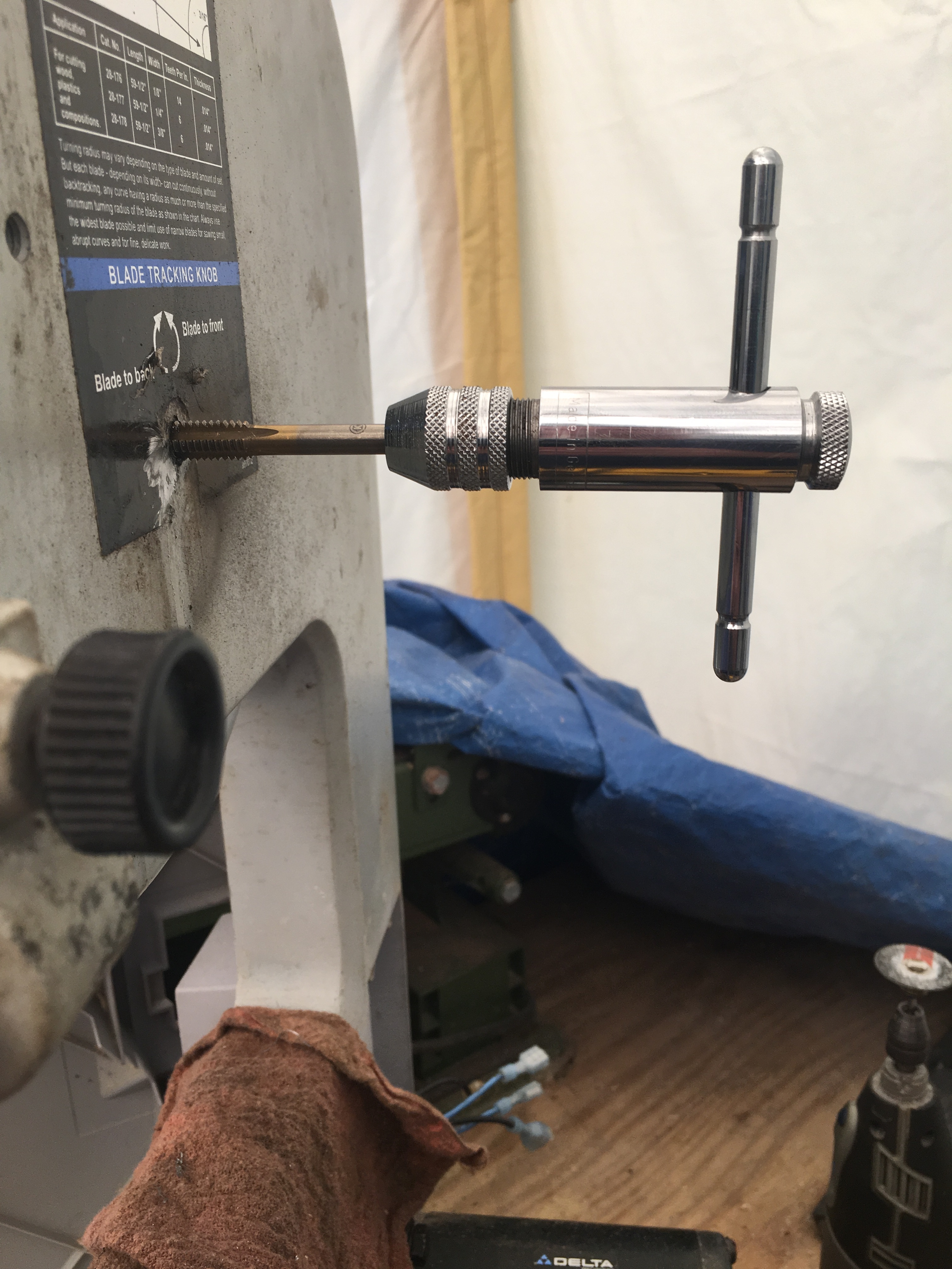

Good news / bad news. Good news is that I got the bolt off. Bad news is that it was only the outer end, the threads never loosened up. Going to completely drill it out and tap new threads.
Successful retapping. Even Had a correct size bolt on hand. Will have to make a knob end and get a new compression spring to tension the bolt, the old spring was too corroded. That’s it for the day. May tried to pick back up tomorrow afternoon.

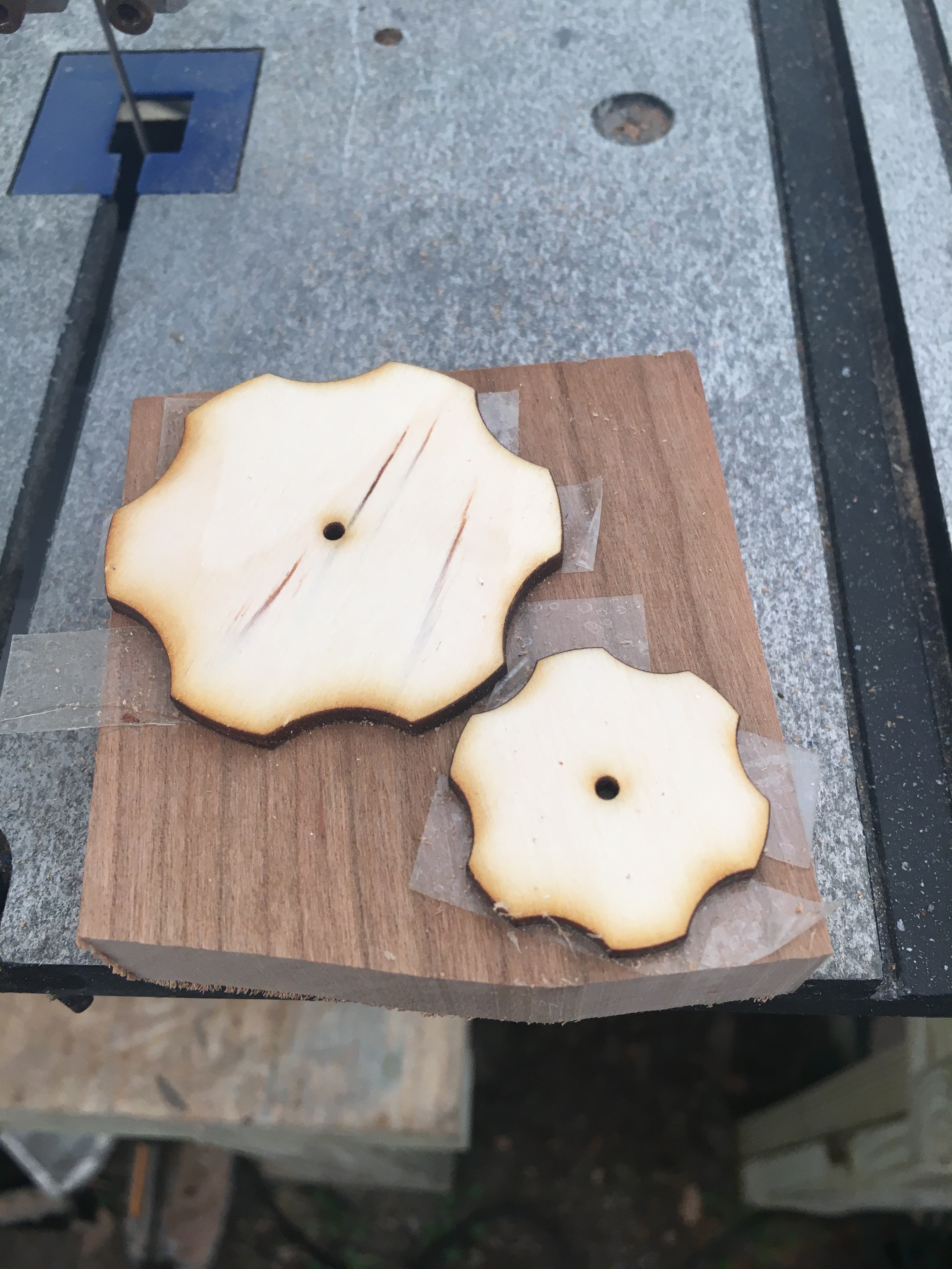

Making replacement knobs. One for the blade tracking and another for the table tilt. Designed and laser cut the knob patterns from 1/8" ply. Used double sided tape to attach the patterns to a scrap piece of 3/4" cherry. Used my original bandsaw to cut the pieces out close to the pattern. Had previously bought a spiral upcut bit, with a flush bearing on the end, to do pattern cutting on my router table. First time using it and it worked pretty well. Definitely need to cut close to the pattern first, especially for thicker material, as it’s not going to remove tons of material quickly. Also had to set the speed of the router to the lowest setting to help keep control of these small pieces and work slow.
Drilled a hole and inserted the carriage bolt for the blade tracking into the smaller knob. Used a washer and nut to sandwich the knob and added a tension spring. Will just have to figure out the extract length I need and shorten the bolt a bit so the tension spring gets compressed.

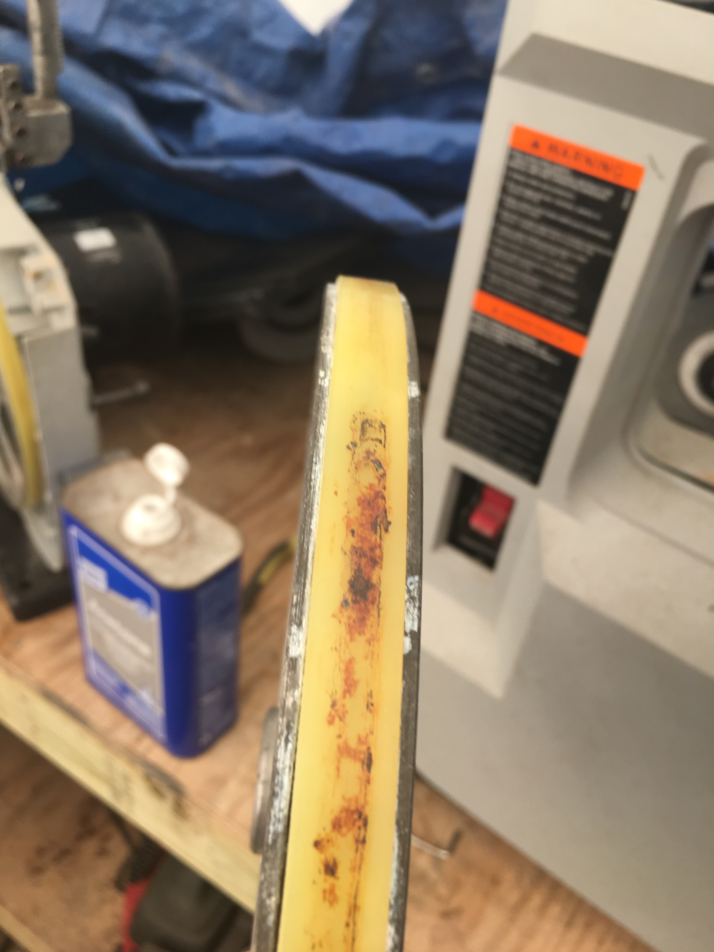

The tires on the wheels had embedded rust from the blade. The rust would not come off with regular cleaner and a scrub pad. Decided to try a little acetone on a paper towel hoping the acetone would slightly soften the surface of the rubber releasing the rust. Worked like a charm with no damage to the tire.
