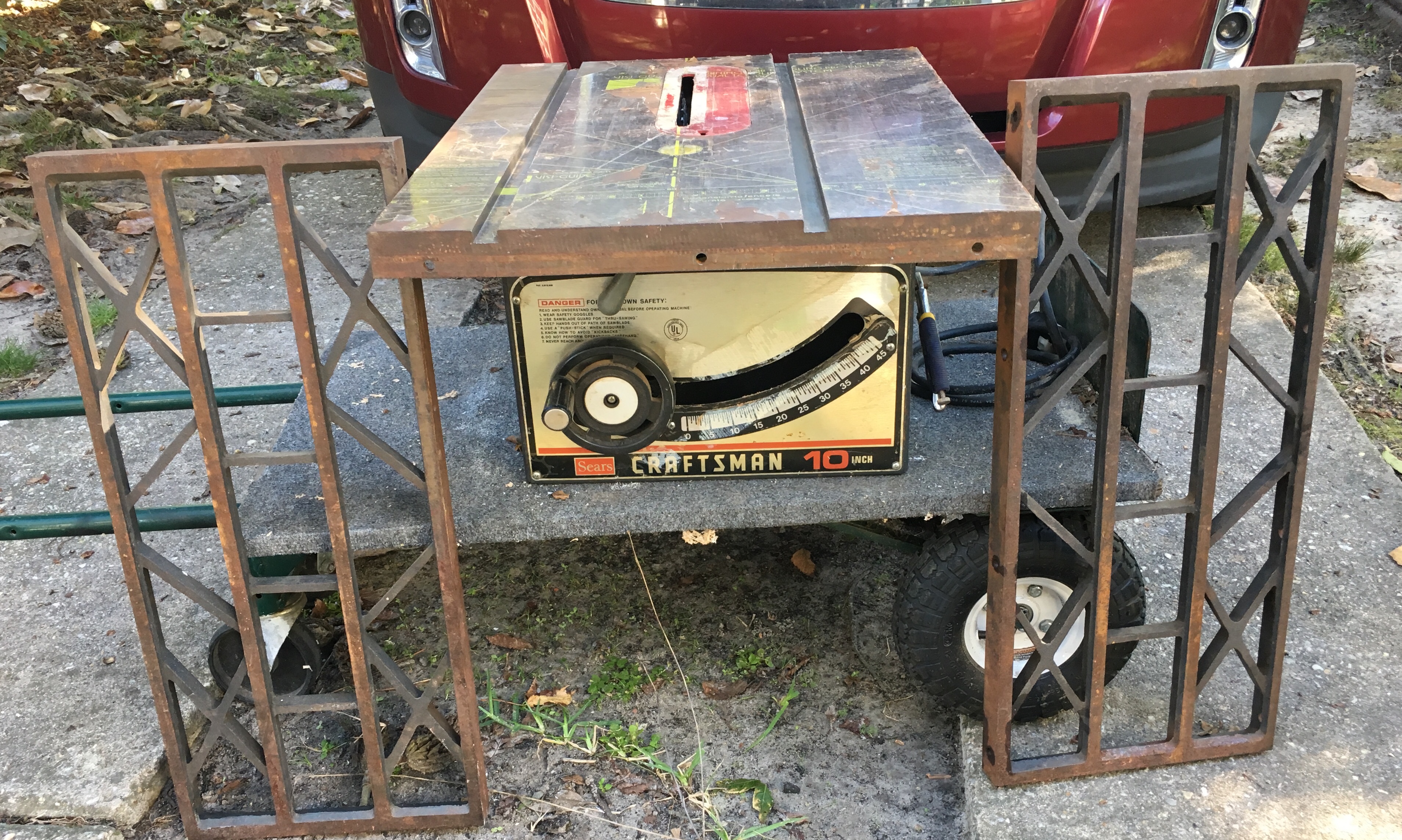

So what have I got? It’s a 10" craftsman contractor table saw model 113.298720 with a 1.5HP motor. Probably dates to the early 1980s. Cast iron top but no rip fence or rip fence rails. The guy was using a piece of angle iron and squeeze camps as a fence which he gave to me as well. Nice Milwaukee clamps. Also has a nice Delta miter gauge and a Rigid brand tool stand. Missing the blade tilt wheel and handle. He was using a small pair of vice grips which he included as well. Small amount of surface rust here and there. All and all looks good. Haven’t tried to fire it up yet.
Biggest thing is to see if I can sort out a decent fence set up that will not cost me an arm and a leg.

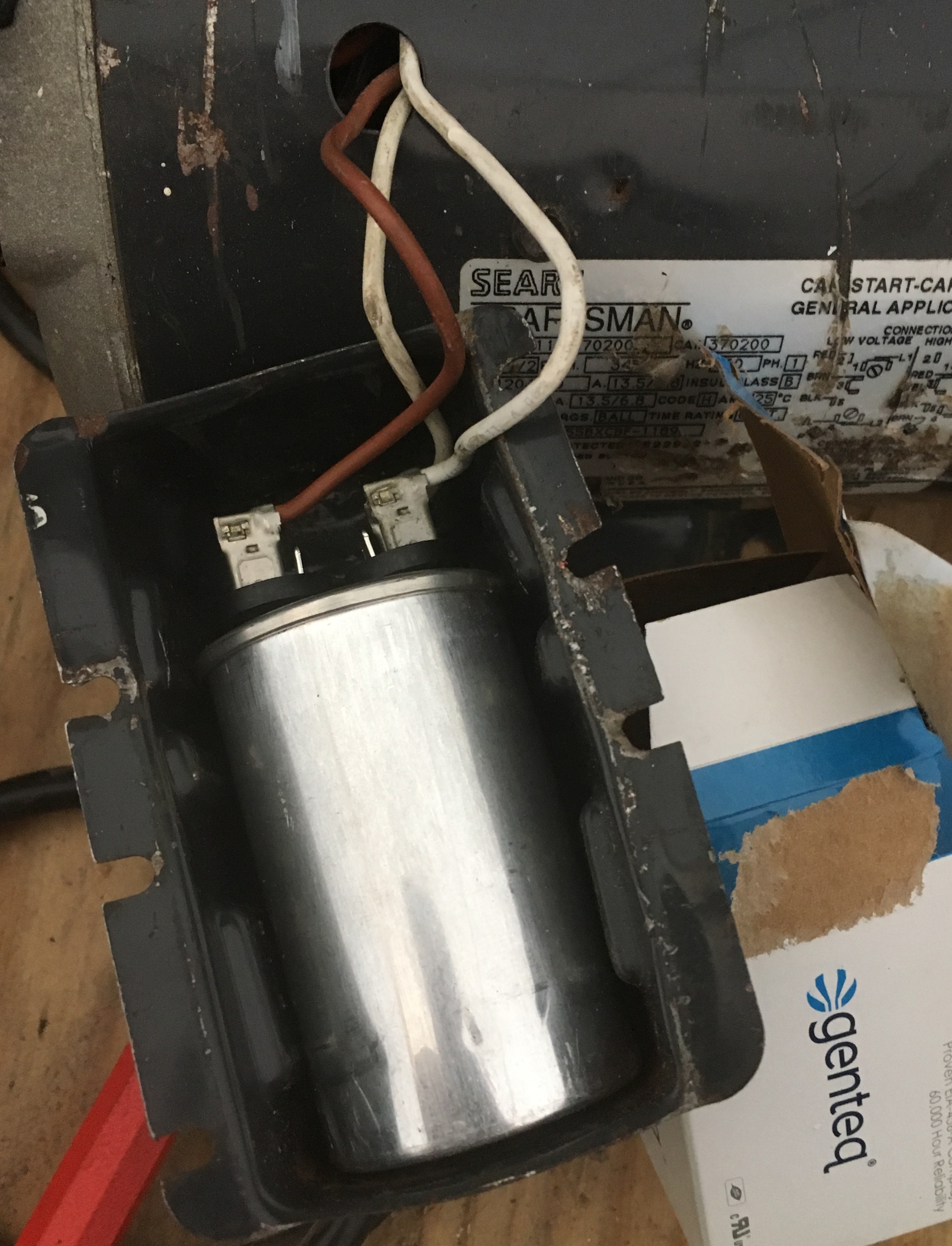

So finally got a chance to take a good look at the saw this afternoon. Seems that my initial assessment that the table landed full table down first was mistaken. The motor sticks out the back and has 2 capacitors, one of which is on the very end. The housing for that capacitor showed fresh scratches and severe denting.
The housing was leaking a very viscous fluid so I opened it up and found that the plastic housing of the capacitor was ruptured. So it appears that the table first landed on end of the motor housing on the capacitor.
The motor mounting bracket was also a little bent (inside bottom of the bracket) and the bracket positioning assembly showed where the the set screws were dragged along the the guides.
As far as I can tell those things are where most of the collision energy went and the fixes seem to be easy enough. Will definitely will have to do a full realignment on the saw.
This is my first “real” table saw that is capable of very precise cuts if set up properly, so I’ve been reading up a bunch. Since I have a “contractor” style saw, with motor out the back, it seems that I might want to invest in a PALS (Precision Alignment & Locking System) for the rear trunnion to make alignment easier.
First though I need to source a new run capacitor for the motor.
Got a new run capacitor late today from Amazon. I was unable to find a reference to a preferred capacitor for the motor so I just found one with the right specs and what I thought were matching dimensions.
Turns out the body of the capacitor was about 2mm taller so it didn’t quite fit the internal stampings of the housing that lock the capacitor in place. However, I had to pound out the crushed part of the housing anyway so I pounded out some modifications so the capacitor would fit and everything would lay flush to the motor body.
Hooked everything up and the motor ran fine. :confetti_ball:
