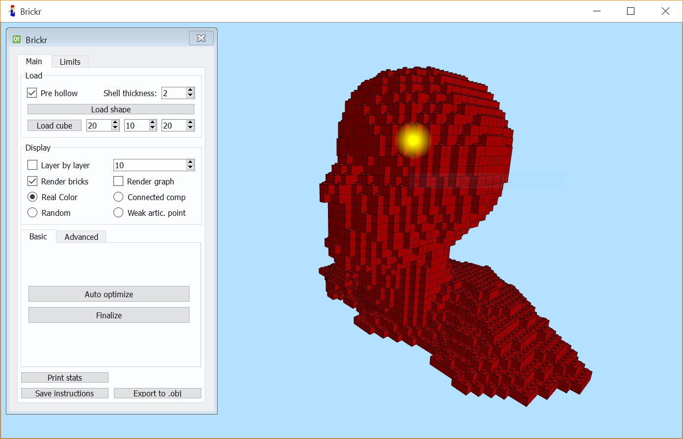

I generated a buste out of #LEGO bricks with #Brickr. Now the model consists of many parts. How can I combine all parts into one? Is there a programm which does this?

I set the resolution in Brickr to 50 but I don’t know exactly what it defines. ![]()
