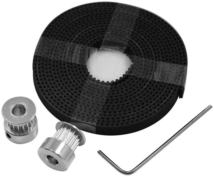

If you are targeting GT2 ( not sure as I don’t have such a lasercutter ) and open belt situation, so to be closed on or by the carrier you could check Amazon and get 6m pieces for a few bucks.
If your Firmware is
Flexible you also could think about changing the pulleys for GT2 use there are also different sizes / toothcounts available… To improve availability of belts for your system…
