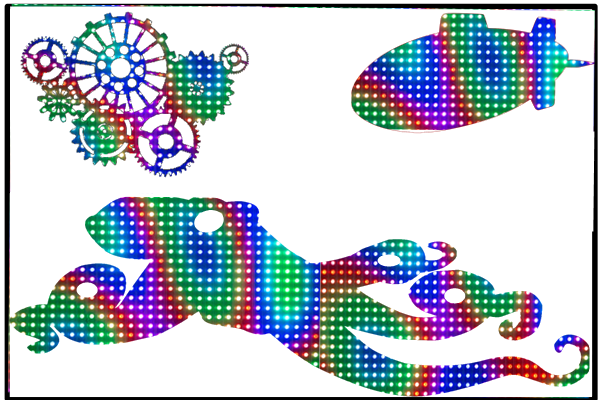

Here is a very crude mock-up of what what the piece would look like.
This is a generic top without colour or pattern. Open to lots of ideas.
whiteTop
This one has a wood pattern but it’s too intense so still thinking on it.
woodTextureTabletop
This one is an attempt to replicate a frosted acrylic top to soften the large sections of LED
frostedTopTable
Generally speaking, I think the large silhouettes create too much open space. I like the more intricate gears better but this will be up to the graphic designer to work with.
