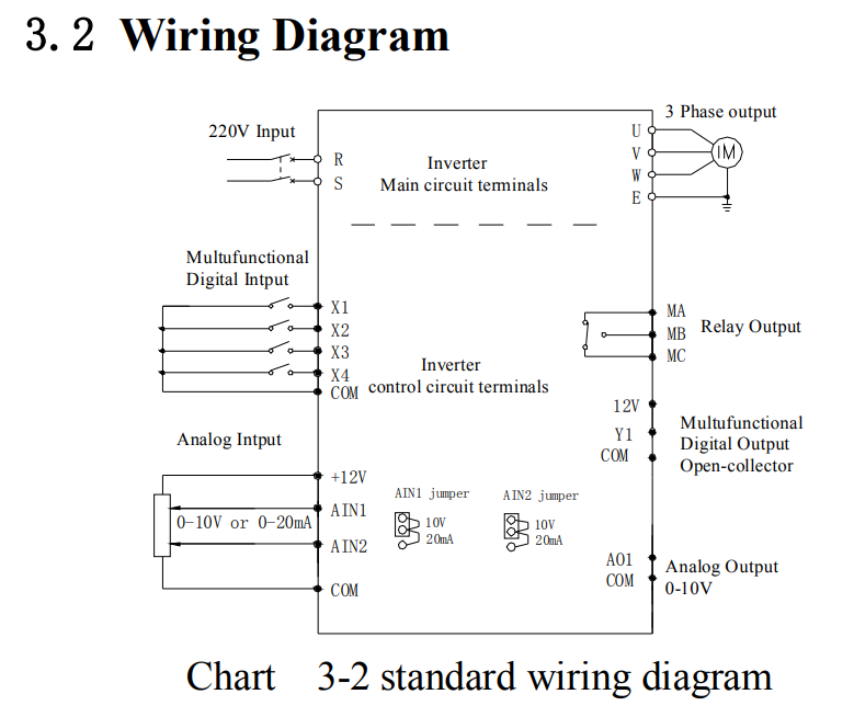

Looking at the wiring diagrams for the E100 VFD (best I can find), you can close the contact between common and X1 or X2 to switch between forward and reverse. Not sure how to get Grbl to change the output based on direction. You will have to read up on that.
Here is where I found the manual for the E100: NOWFOREVER MANUAL E-100.pdf | DocDroid
