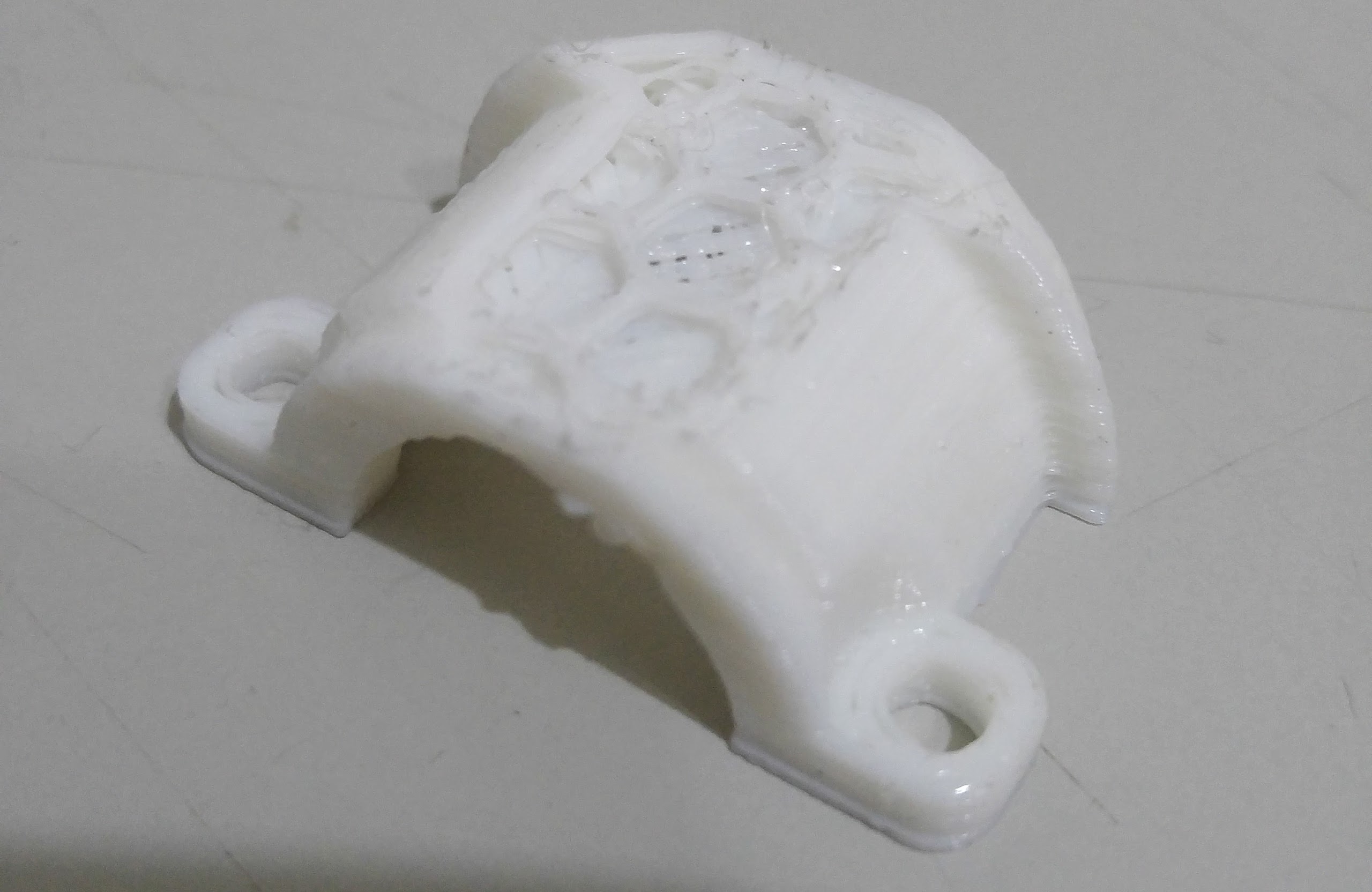

I’m running PLA @ 215 (tried up to 225, down to 195) on a heated bed, both with and without a cooling fan on the part. Printer is Davinci 2.0 running Repetier.
I keep getting half prints. The quality of the part that does print looks great, but just can’t get a full part anymore. The printer goes through the motion, but the plastic doesn’t extrude after a certain point (different heights each time). This plastic has given me a bigger headache than the previous one I used. I’ve only gotten a handful of successful prints off of it. (I only print small items.)
