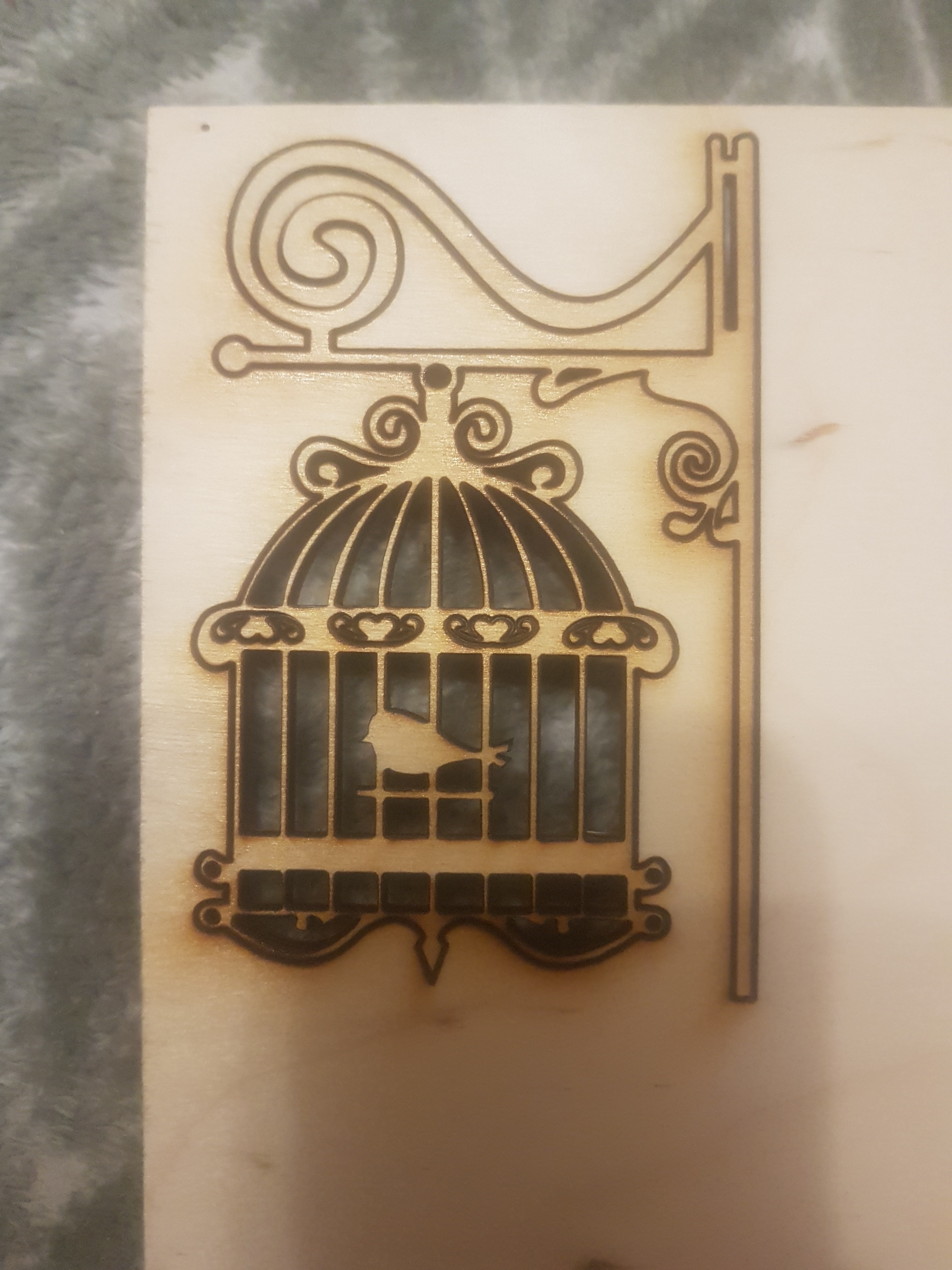

Need help. Why its not cut out everywhere? What im doing wrong?
Decrease cutting speed,or Increase power as slight varattions in wood density and or mirror alignment out slightly.
What setting did you use to cug
Glue in wood
@Phillip_Conroy
Thank you for answer
Speed: 25units (mm/s?)
Power; around 50%. 14mV
Material: Plywood 3mm
I would equally guess poor quality tube and possibly mirrors misalignment.
I would slow the speed way down.
