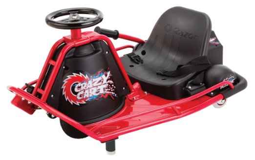

My son has this Crazy Cart…it is crazy - no brakes! I thought this would be a great project to get him more involved in some IoT. (He’s 8)
I wanted to add a few LEDS light strips that would be activated in different modes based an accelerometer.
For example when accelerating have the LED strips sequence in Green, and under deceleration have them sequence backwards in red. Maybe Blue pulsing when idle and some random stuff when spinning.
My current plan is to use an ESP8266 with some WS2812bs but not sure the ESP can handle it. Can the ESP8266 control 2 or 3 individual strips? If not, what is another good low power microprocessor.
The ADXL345 seems like the commonly uses accelerometer.
Are 60 led/meter WS2812s a god choice?
Hoping to be able to run this off a large Portable USB Battery Pack/Charger.
