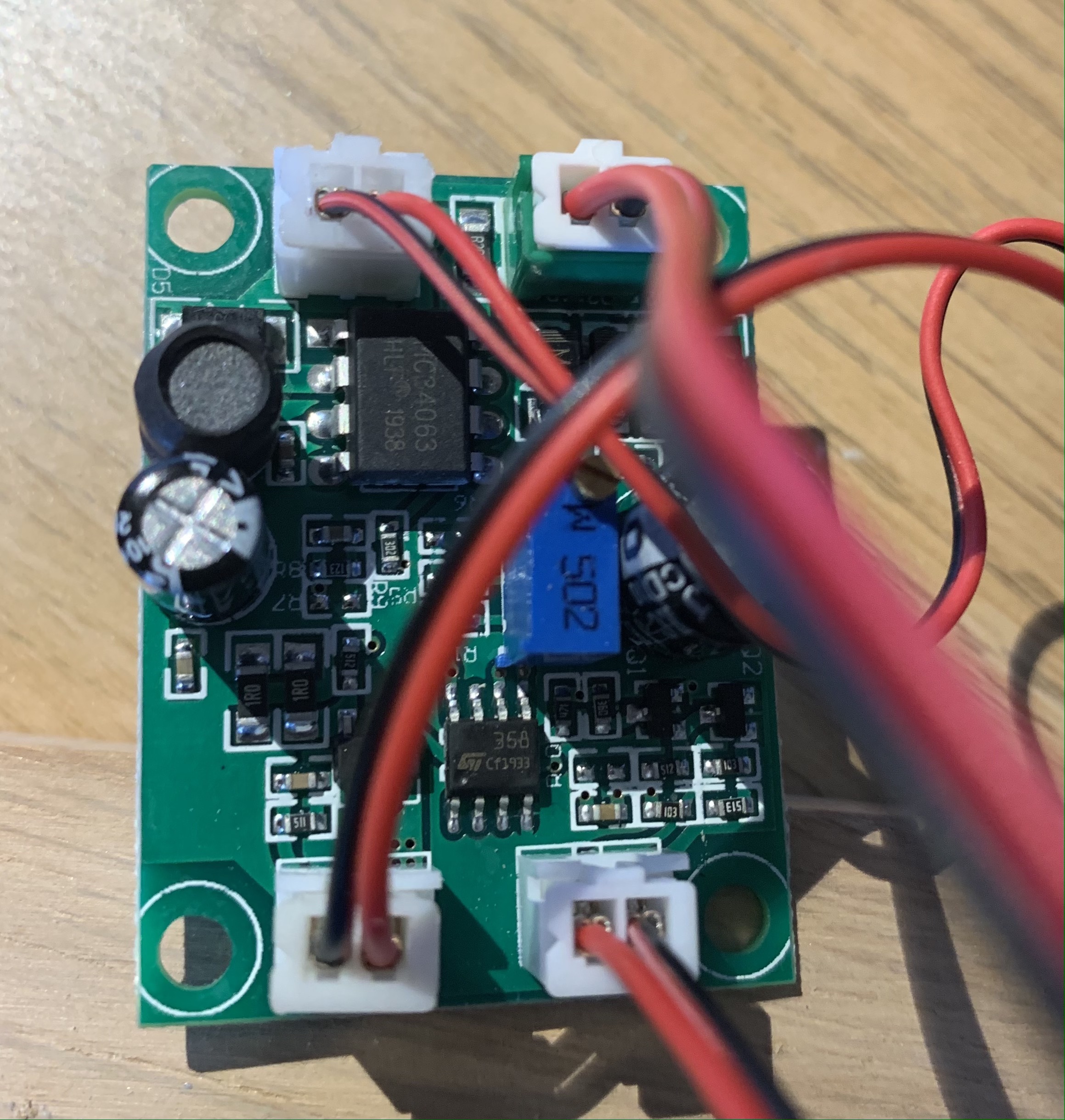

Please post your $$ settings and a picture of the laser driver.

I will try Laserburn tonight then. Thanks for that suggestion. I attach a photo of the driver. The TTL input is in the lower right corner. As I said, this works fine when I send PWM via analogWrite().
Wow, I finally got it. I tried Laserburn and that worked instantly. When I compared the gcode from LaserWeb, I found that the LaserWeb code is missing the M4 command at the beginning. When I added that into the Gcode Start field of the settings, the LaserWeb code worked just as well. Thank you for helping out!
