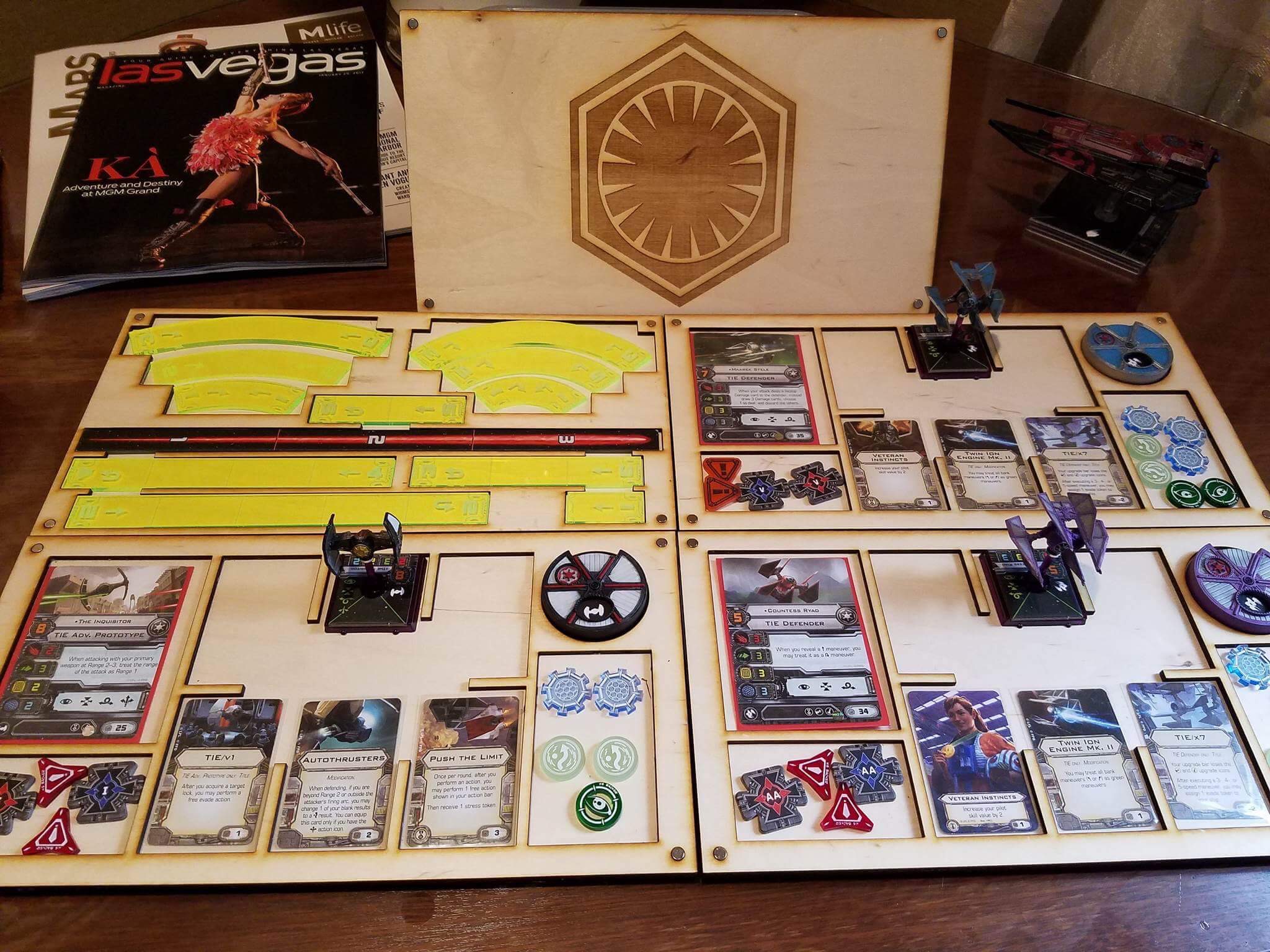

Need some glue help. I make card trays out of birch plywood.
Need some glue help. I make card trays out of birch plywood. I have been using spray glue to Adhere the two layers together however I do get over spray of globes in a few areas making it less than ideal. Any suggestions on the best way to glue the layers together. And do it ina way that doesn’t takes just a minute or two

Have you tried 3M Super 77 spray adhesive? I would spray the back of the top cutout layer and then flip it over and place it on the bottom. You might want to make a jig to align the top and bottom. Super 77 sets really fast so you pretty much only get over go at it. I used it for layered vaneer bookmarks and it worked great without warping.
@Jeff1 that is what I have used in the past but the web spay is a pain. I have been spraying it on paper and then “stamping”. The top part into it and then gluing it to the bottom but after a few set ups it gets really messy and globs of glue are everywhere

If you are doing a lot of these, glue the cutouts to a base board in reverse order, flip the frame over on top of them and then spray, roll or brush glue. The cutouts keep the glue from getting where you don’t want it…maybe :slight_smile:
